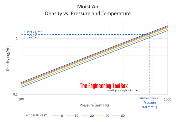

Moist Air - Density vs. Pressure
Density of moist air vs. pressure ranging 75 - 1000 mmHg.
Density of moist air with dew point 10 oC vs. pressure is indicated below.
density moist air
