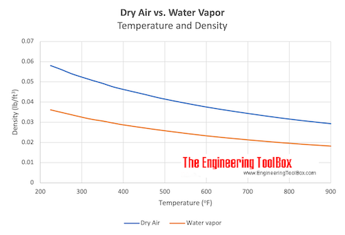

Dry air vs. water vapor - density vs. temperature
