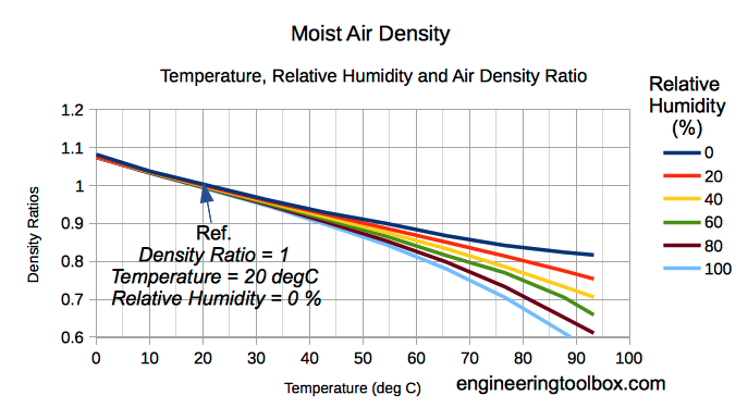

Density of Moist Air - an Air Vapor Mixture
The amount of water vapor in air influences the density. Water vapor is relatively light compared to diatomic Oxygen and diatomic Nitrogen - the dominant components in air .
When vapor content increases in moist air the amount of Oxygen and Nitrogen are decreased per unit volume and the density of the mix decreases since the mass is decreasing.
Based on specific volume of moist air the moist air density can be calculated
ρ = 1 / v
= (p / R a T) (1 + x) / (1 + x R w / R a ) (3)
v = specific volume of moist air per mass unit of dry air and water vapor (m3 /kg)
x = m w / m a = specific humidity or humidity ratio (kg h2o /kg dry_air )
m w = mass of water vapor (kg)
m a = mass of dry air (kg)
p = pressure in the moist air (Pa)
The density of dry air with the same total pressure p as in the mixture (dry air + vapor partial pressure) - can be calculated as a reference as
ρ ref = p / R a T (4)
ρ ref = reference density of dry air with the same pressure as in the air vapor mixture (kg/m3 )
The density of moist air related to dry air can be expressed by combining (4) and (3) as
ρ = ρ ref (1 + x) / (1 + x R w / R a ) (5)
The gas constant ratio between water vapor and air is
R w / R a = (461.5 J/kg K) / (286.9 J/kg K)
= 1.609
and inserting the ratio in (5) the density of moist air related to dry air can be expressed as
ρ = ρ ref (1 + x) / (1 + 1.609 x ) (6)
Note! As we can see from (6) - increased moisture content reduces the density of moist air - dry air is more dense than moist air.
