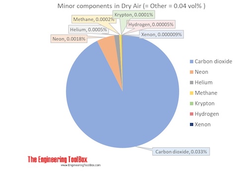

The molar mass of dry air is 28.9647 g/mol. Composition and content of each gas in air is given in the figures and the table below.

Components in dry air | Volume ratio = Molar ratio compared to dry air |
Molar mass | Molar mass in air | Atmospheric boiling point |
Name | Formula | [mol/mol air ] | [vol%] | [g/mol], [kg/kmol] |
[g/mol air ], [kg/kmol air ] |
[wt%] | [K] | [°C] | [°F] |
Nitrogen | N 2 | 0.78084 | 78.084 | 28.013 | 21.872266 | 75.511 | 77.4 | -195.8 | -320.4 |
Oxygen | O 2 | 0.20946 | 20.946 | 31.999 | 6.701942 | 23.14 | 90.2 | -183.0 | -297.3 |
Argon | Ar | 0.00934 | 0.934 | 39.948 | 0.373025 | 1.29 | 87.3 | -185.8 | -302.5 |
Carbon dioxide 1) | CO 2 | 0.000412 | 0.0412 | 44.010 | 0.018132 | 0.063 | 194.7 | -78.5 | -109.2 |
Neon | Ne | 0.00001818 | 0.001818 | 20.180 | 0.000367 | 0.0013 | 27.2 | -246.0 | -410.7 |
Helium | He | 0.00000524 | 0.000524 | 4.003 | 0.000021 | 0.00007 | 4.2 | -269.0 | -452.1 |
Methane | CH 4 | 0.00000179 | 0.000179 | 16.042 | 0.000029 | 0.00010 | 111.7 | -161.5 | -258.7 |
Krypton | Kr | 0.0000010 | 0.0001 | 83.798 | 0.000084 | 0.00029 | 119.8 | -153.4 | -244.0 |
Hydrogen | H 2 | 0.0000005 | 0.00005 | 2.016 | 0.000001 | 0.000003 | 20.3 | -252.9 | -423.1 |
Xenon | Xe | 0.00000009 | 0.000009 | 131.293 | 0.000012 | 0.00004 | 165.1 | -108.1 | -162.5 |
Average molar mass of air | 28.9647 |
