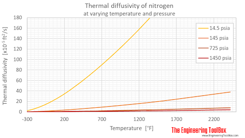

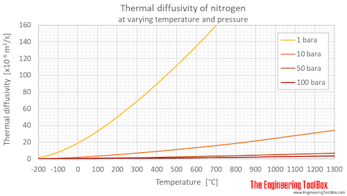

Thermal diffusivity of nitrogen at 1, 10, 50 and 100 bara (14.5, 145, 725 and 1450 psia), and varying temperature given as °C or °F:
Nitrogen thermal diffusivity pressure C
Nitrogen thermal diffusivity pressure F

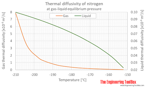

Thermal diffusivity of nitrogen at gas-liquid equilibrium pressure and varying temperature given as °C or °F:
Nitrogen thermal diffusivity equilibrium C
Nitrogen thermal diffusivity equilibrium F
