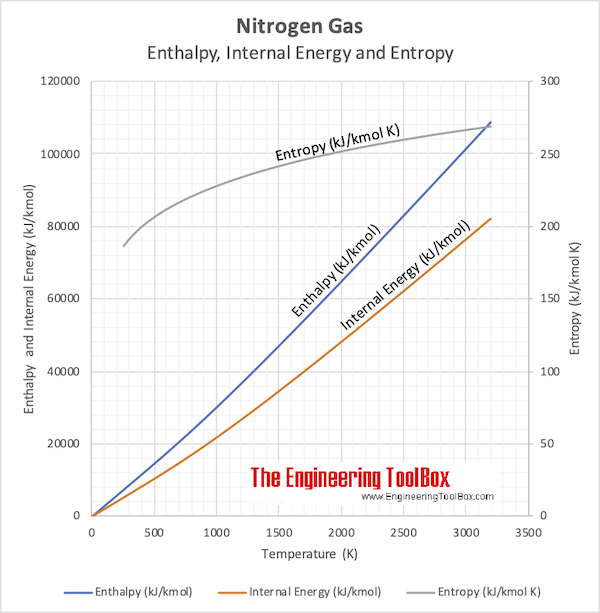

Nitrogen - Enthalpy, Internal Energy and Entropy vs. Temperature
Enthalpy, internal energy and entropy of Nitrogen as an ideal gas.
  • Enthalpy
  • Internal Energy
  • Absolute Entropy at standard reference pressure
for Nitrogen - N2 - for temperatures ranging 0 - 3000 K, are indicated in the diagram below.
Nitrogen gas properties - enthalpy, internal energy, entropy, diagram
Download and print Nitrogen Gas Enthalpy, Internal Energy and Entropy Chart
