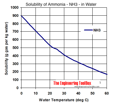

Solubility of Ammonia - NH3 - in Water
solubility diagram - Ammonia - nh3 - in water at different temperatures

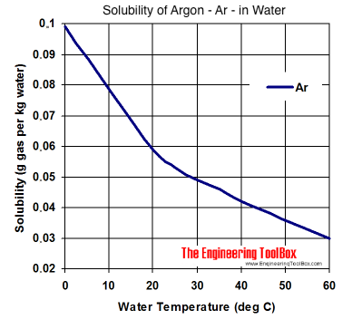

Solubility of Argon - Ar - in Water
Solubility diagram - argon - Ar - in water at different temperatures

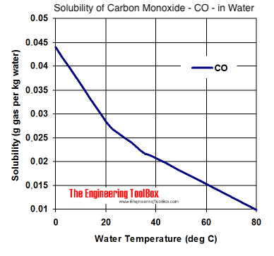

Solubility of Carbon Monoxide - CO - in Water
Solubility diagram - carbon monoxide - CO - in water at different temperatures

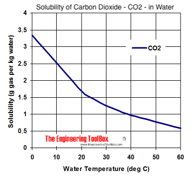

Solubility of Carbon Dioxide - CO2 - in Water
Solubility diagram - carbon dioxide - CO2 - in water at different temperatures

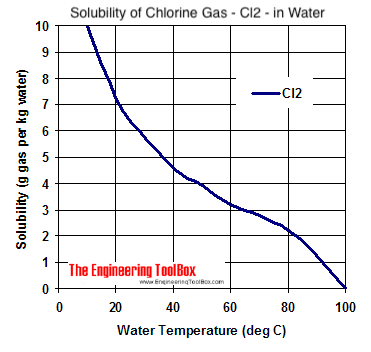

Solubility of Chlorine Gas - Cl2 - in Water
Solubility diagram - chlorine gas - Cl2 - in water at different temperatures

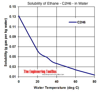

Solubility of Ethane - C2H6 - in Water
Solubility diagram - ethane - C2H6 - in water at different temperatures

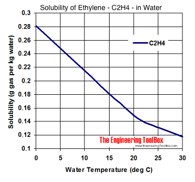

Solubility of Ethylene - C2H4 - in Water
Solubility diagram - ethylene - C2H4 - in water at different temperatures

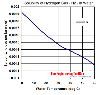

Solubility of Hydrogen Gas - H2 - in Water
Solubility diagram - hydrogen gas - h2 - in water at different temperatures

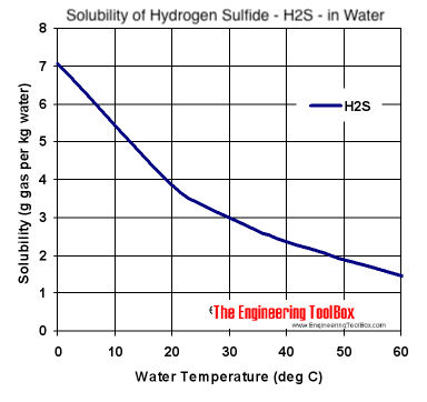

Solubility of Hydrogen Sulfide - H2S - in Water
Solubility diagram - hydrogen sulfide - h2s - in water at different temperatures

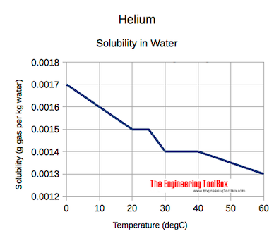

Solubility of Helium - He - in Water
Solubility diagram - helium - he - in water at different temperatures

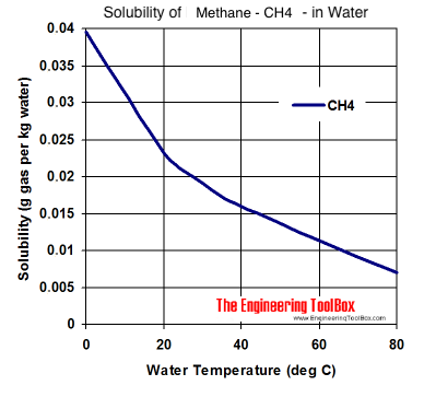

Solubility of Methane - CH4 - in Water
Solubility diagram - methane - CH4 - in water at different temperatures

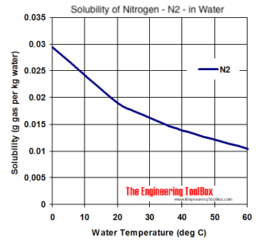

Solubility of Nitrogen - N2 - in Water
solubility diagram - Nitrogen - n2 - in water at different temperatures

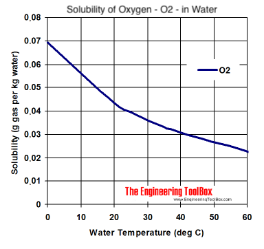

Solubility of Oxygen - O2 - in Water
solubility diagram - Oxygen - o2 - in water at different temperatures

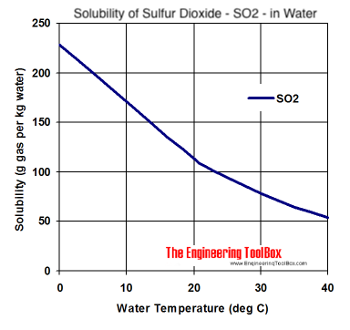

Solubility of Sulfur Dioxide - SO2 - in Water
solubility diagram - Sulfur Dioxide - so2 - in water at different temperatures
