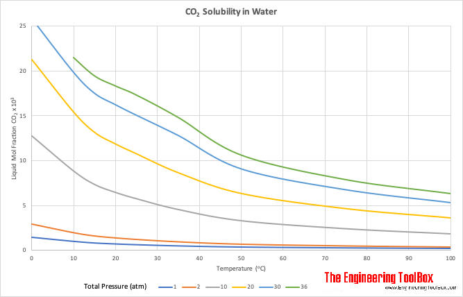

Solubility of CO2 in Water
CO2 - solubility in water
  • liquid mol fraction CO2 x 103
