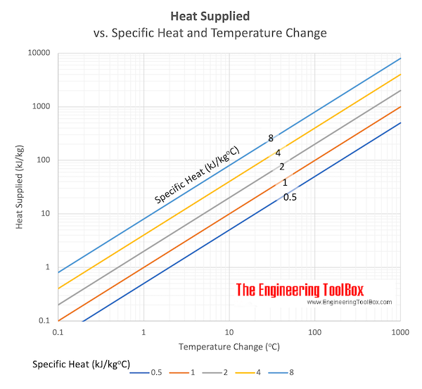

Specific Heat Capacity ( c ) is the amount of heat required to change the temperature of a mass unit of a substance by one degree. Specific heat is a more common term for the same.
The heat supplied to a mass can be expressed as
dQ = m c dt                               (1)
dQ = heat supplied (J, kJ Btu)
m = unit mass (g, kg, lb)
c = specific heat (J/g K, kJ/kg oC, kJ/kg K, Btu/lb oF)
dt = temperature change (K, C °, oF)
(1) can be transferred to express Specific Heat as:
c = dQ / m dt (1b)

Heat supplied v. specific heat and change in temperature chart
Download and print Heat supplied vs. Specfic heat and change in Temperature chart
