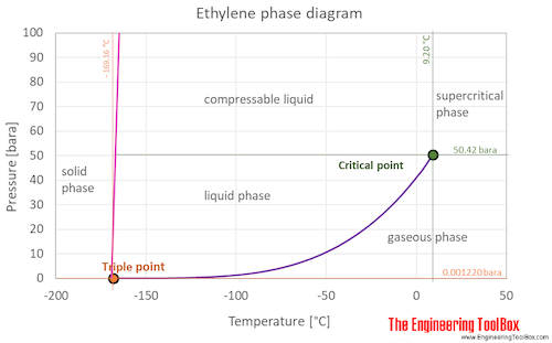

Ethylene is a gas at standard conditions. However, at low temperature and/or high pressures the gas becomes a liquid or a solid.
The ethylene phase diagram shows the phase behavior with changes in temperature and pressure. The curve between the critical point and the triple point shows the ethylene boiling point with changes in pressure. It also shows the saturation pressure with changes in temperature.
Ethylene phase diagram
