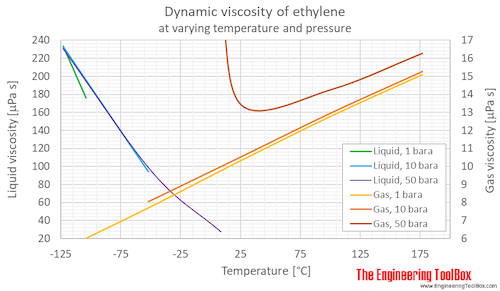

Dynamic viscosity of ethylene at varying temperature and 1, 10 and 50 bara (14.5, 145 and 725 psia):
Ethylene dynamic viscosity pressure C

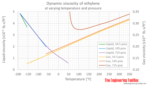

Ethylene dynamic viscosity pressure F

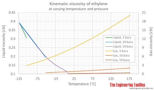

Kinematic viscosity of ethylene at varying temperature and 1, 10 and 50 bara (14.5, 145 and 725 psia):
Ethylene kinematic viscosity pressure C

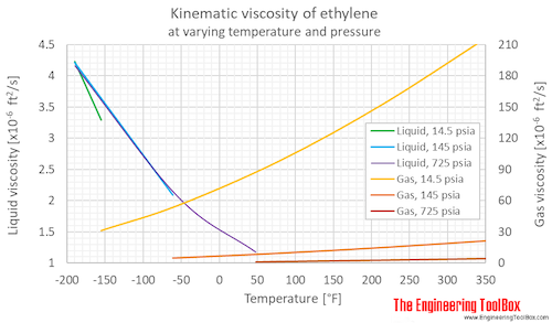

Ethylene kinematic viscosity pressure F

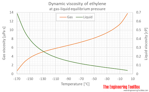

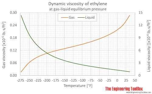

Dynamic viscosity of ethylene at gas-liquid equilibrium pressure:
Ethylene dynamic viscosity equilibrium C
Ethylene dynamic viscosity equilibrium F

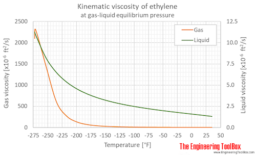

Kinematic viscosity of ethylene at gas-liquid equilibrium pressure:
Ethylene kinematic viscosity equilibrium C

103.99 -169.16 -272.49 1.22E-03 0.0177 685.7 0.6857 14.32 460.8 1.659 1.048 11.28
105 -168 -271 1.46E-03 0.0211 662.5 0.6625 13.84 445.2 1.603 1.014 10.92
115 -158 -253 6.97E-03 0.101 488.1 0.4881 10.19 328.0 1.181 0.7620 8.202
125 -148 -235 0.0253 0.366 378.7 0.3787 7.909 254.5 0.9161 0.6033 6.494
135 -138 -217 0.0739 1.07 305.5 0.3055 6.381 205.3 0.7390 0.4971 5.350
145 -128 -199 0.183 2.66 253.8 0.2538 5.301 170.5 0.6140 0.4221 4.543
155 -118 -181 0.398 5.77 215.7 0.2157 4.505 144.9 0.5218 0.3670 3.950
165 -108 -163 0.777 11.3 186.4 0.1864 3.893 125.3 0.4509 0.3248 3.496
175 -98.2 -145 1.39 20.2 163.0 0.1630 3.404 109.5 0.3943 0.2913 3.136
185 -88.2 -127 2.33 33.9 143.9 0.1439 3.005 96.70 0.3481 0.2642 2.844
195 -78.2 -109 3.69 53.5 127.7 0.1277 2.667 85.81 0.3089 0.2413 2.597
205 -68.2 -90.7 5.56 80.7 113.8 0.1138 2.377 76.47 0.2753 0.2218 2.388
215 -58.2 -72.7 8.05 117 101.4 0.1014 2.118 68.14 0.2453 0.2045 2.202
225 -48.2 -54.7 11.3 164 90.22 0.09022 1.884 60.63 0.2183 0.1891 2.035
235 -38.2 -36.7 15.3 223 79.89 0.07989 1.669 53.68 0.1933 0.1748 1.882
245 -28.2 -18.7 20.4 296 70.14 0.07014 1.465 47.13 0.1697 0.1614 1.738
255 -18.2 -0.7 26.5 384 60.69 0.06069 1.268 40.78 0.1468 0.1486 1.599
265 -8.1 17.3 33.9 492 51.11 0.05111 1.067 34.34 0.1236 0.1358 1.461
275 1.9 35.3 42.8 620 40.40 0.04040 0.8438 27.15 0.09773 0.1221 1.314
Gas at
equilibrium
103.99 -169.16 -272.49 1.22E-03 0.0177 0.773 7.73E-04 0.01614 0.5192 1.87E-03 195.2 2101
105 -168.2 -271 1.46E-03 0.0211 1.001 1.00E-03 0.02091 0.6726 2.42E-03 213.8 2301
115 -158.2 -252.7 6.97E-03 0.101 2.734 2.73E-03 0.05710 1.837 6.61E-03 133.5 1437
125 -148.2 -234.7 0.0253 0.366 3.826 3.83E-03 0.07991 2.571 9.26E-03 55.98 602.6
135 -138.2 -216.7 0.0739 1.07 4.558 4.56E-03 0.09520 3.063 0.01103 24.55 264.3
145 -128.2 -198.7 0.183 2.66 5.089 5.09E-03 0.1063 3.420 0.01231 11.83 127.3
155 -118.2 -180.7 0.398 5.77 5.511 5.51E-03 0.1151 3.703 0.01333 6.261 67.39
165 -108.2 -162.7 0.777 11.3 5.880 5.88E-03 0.1228 3.951 0.01422 3.599 38.74
175 -98.2 -145 1.39 20.2 6.228 6.23E-03 0.1301 4.185 0.01507 2.220 23.90
185 -88.2 -127 2.33 33.9 6.577 6.58E-03 0.1374 4.420 0.01591 1.452 15.63
195 -78.2 -109 3.69 53.5 6.941 6.94E-03 0.1450 4.664 0.01679 0.9976 10.74
205 -68.2 -90.7 5.56 80.7 7.334 7.33E-03 0.1532 4.928 0.01774 0.7136 7.681
215 -58.2 -72.7 8.05 117 7.769 7.77E-03 0.1623 5.221 0.01879 0.5278 5.681
225 -48.2 -54.7 11.3 164 8.261 8.26E-03 0.1725 5.551 0.01998 0.4013 4.319
235 -38.2 -36.7 15.3 223 8.834 8.83E-03 0.1845 5.936 0.02137 0.3120 3.359
245 -28.2 -18.7 20.4 296 9.525 9.53E-03 0.1989 6.401 0.02304 0.2470 2.659
255 -18.2 -0.7 26.5 384 10.4 0.01040 0.2172 6.988 0.02516 0.1980 2.132
265 -8.1 17.3 33.9 492 11.63 0.01163 0.2429 7.815 0.02813 0.1602 1.724
275 1.9 35.3 42.8 620 13.77 0.01377 0.2876 9.253 0.03331 0.1294 1.392
