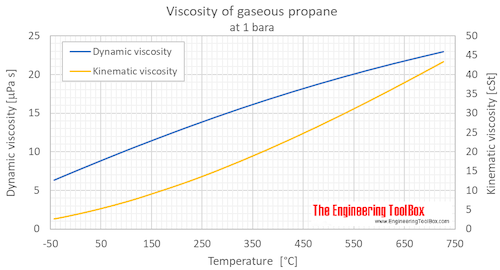

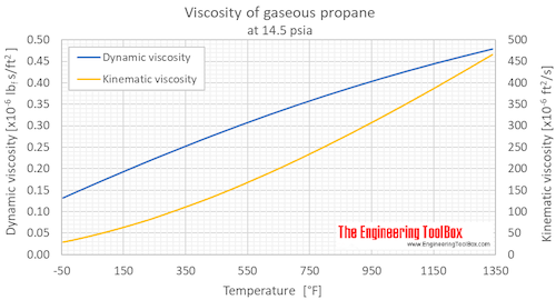

Dynamic and kinematic viscosity of gaseous propane at atmospheric pressure and varying temperature:
Propane viscosity gas 1 bara C
Propane viscosity gas 1 bara F

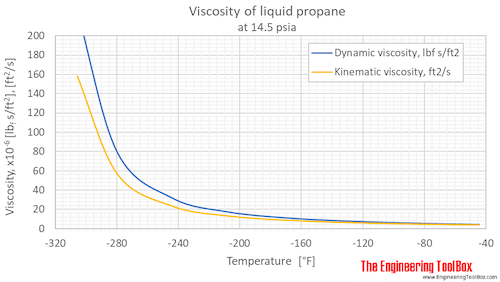

Dynamic and kinematic viscosity of liquid propane at atmospheric pressure and varying temperature:
Propane viscosity liquid 1 bara C
Propane viscosity liquid 1 bara F

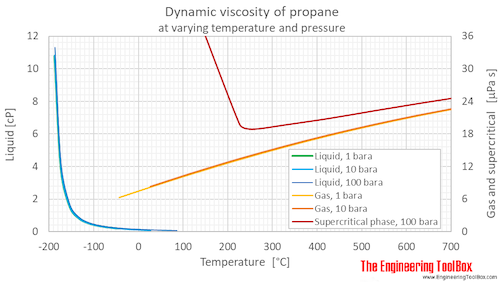

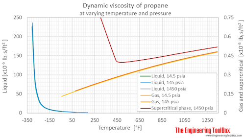

Dynamic viscosity of propane at varying temperature and 1, 10 and 100 bara (14.5, 145 and 1450 psia):
Propane dynamic viscosity pressure C
Propane dynamic viscosity pressure F

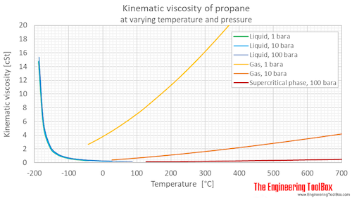

Kinematic viscosity of propane at varying temperature and 1, 10 and 100 bara (14.5, 145 and 1450 psia):
Propane kinematic viscosity pressure C
Propane kinematic viscosity pressure F

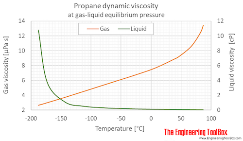

Dynamic viscosity of propane  at gas-liquid equilibrium pressure:
Propane dynamic viscosity equilibrium C

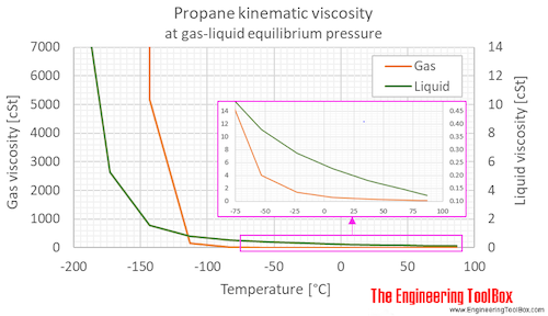

Kinematic viscosity of propane  at gas-liquid equilibrium pressure:
Propane kinematic viscosity equilibrium C
