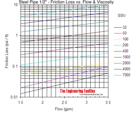

Pipe Size 1/2"
Pipe - pressure loss due to friction with viscous liquids - pipe size 1/2

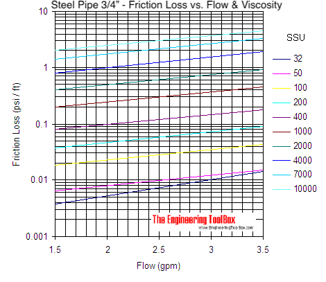

Pipe Size 3/4"
Pipe - pressure loss due to friction with viscous liquids - pipe size 3/4

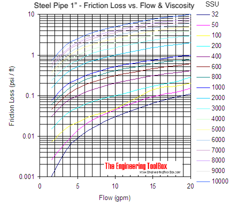

Pipe Size 1"
  • 1 psi/ft = 27.7 inH2O/ft = 22.6 kPa/m
  • 1 gpm = 0.23 m3/h

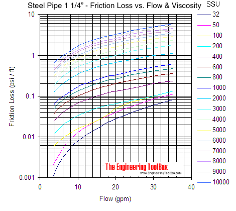

Pipe Size 1 1/4"
Pipe - pressure loss due to friction with viscous liquids - pipe size 1 1/4

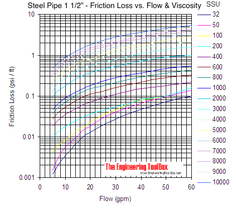

Pipe Size 1 1/2"
Pipe - pressure loss due to friction with viscous liquids - pipe size 1 1/2

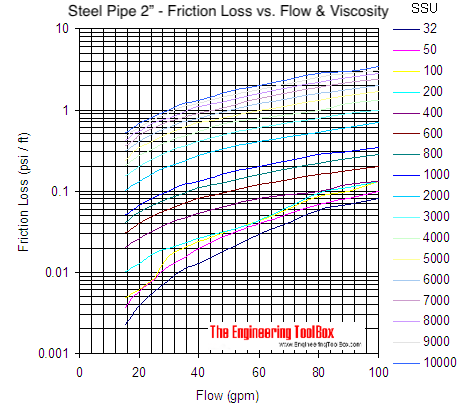

Pipe Size 2"
Pipe - pressure loss due to friction with viscous liquids - pipe size 2

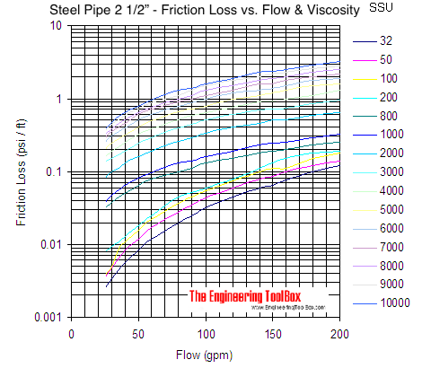

Pipe Size 2 1/2"
Pipe - pressure loss due to friction with viscous liquids - pipe size 2 1/2

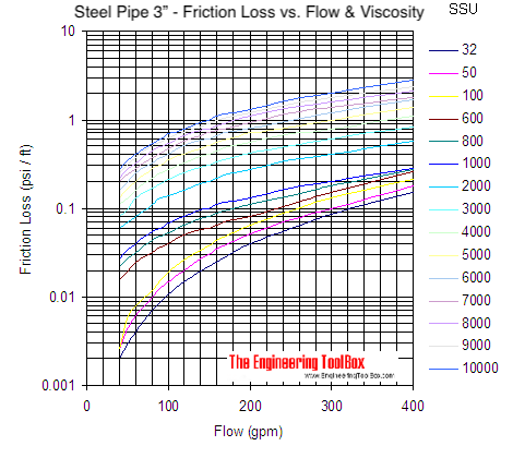

Pipe Size 3"

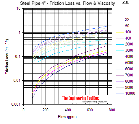

Pipe Size 4"
Pipe - pressure loss due to friction with viscous liquids - pipe size 4
  • 1 gpm = 0.23 m3/h
