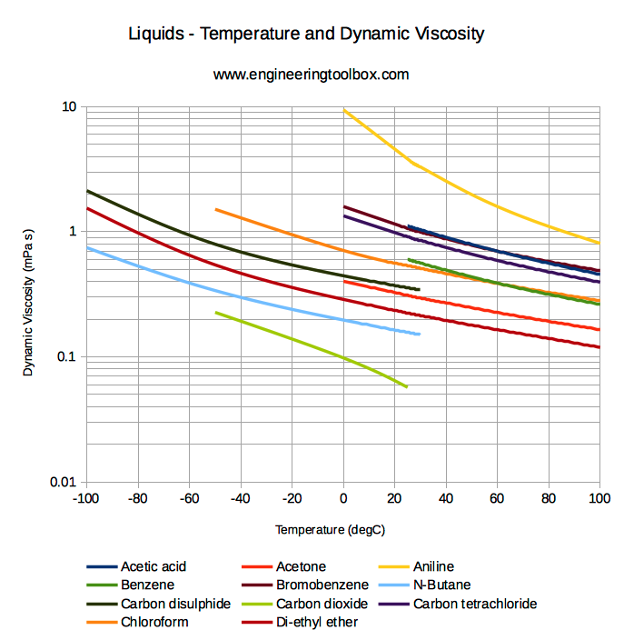

Liquids - Temperature and Dynamic Viscosities
  • Acetic acid
    Acetone
    Aniline
    Benzene
    Bromobenzene
    N-Butane
    Carbon disulphide
    Carbon dioxide
    Carbon tetrachloride
    Chloroform
    Di-ethyl ether
Liquids - dynamic visosities
  • Ethanol
    Ethyl acetate
    Ethyl formate
    N-Hexane
    n-Hexadecane.
    Mercury
    Methanol
    Nitrobenzene
    N-Octane
    Oil, castor
    Oil, olive
    N-Pentane
    N-Propane
    Sulphuric acid
    Toluene
