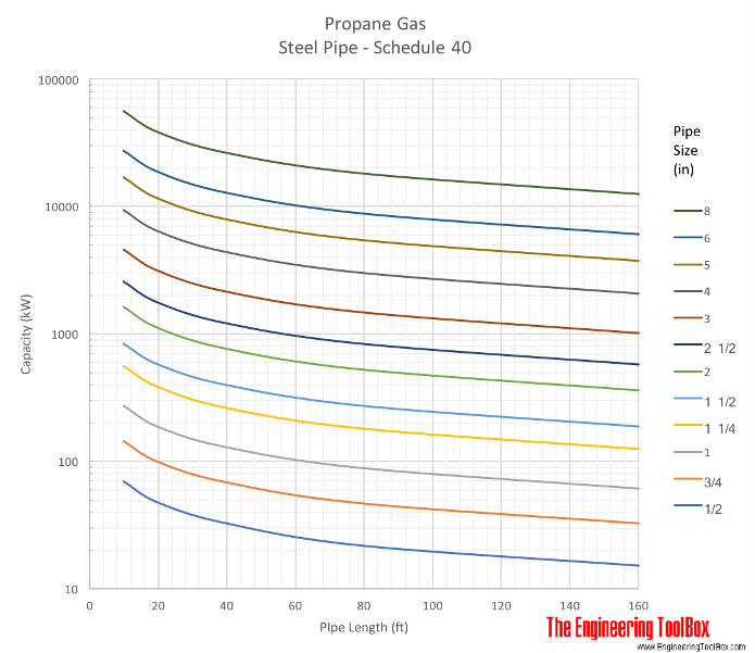

Steel Pipe - Schedule 40
Propane gas pipe sizing diagram - metric units meter
Propane gas pipe sizing diagram - imperial units feet
Propane Gas - Sizing of Sizing of Steel Pipes Schedule 40
Pipe Size
(in)
Capacity of Pipe (kW)
Pipe Length (m)
36122450
1/2 70 48 33 22 15
3/4 145 100 69 47 32
1 274 188 130 89 60
1 1/4 560 387 265 182 123
1 1/2 840 580 400 274 184
2 1625 1117 768 527 354
2 1/2 2590 1780 1223 841 565
3 4580 3145 2160 1487 1000
4 9340 6415 4410 3030 2040
5 16900 11615 7980 5485 3690
6 27360 18800 12920 8880 5970
8 56220 38640 26560 18250 12270
  • pressure less than 10 kPa
  • fittings factor 1.5 - equivalent pipe length = pipe length + 50%
  • pressure drop 125 Pa
  • energy content in propane gas 94 MJ/m3
  • steel pipes schedule 40

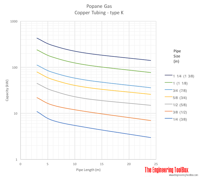

Copper Tubing - type K
Propane gas copper tube sizing diagram - metric units meter
Propane gas copper tube sizing diagram - imperial units feet
Propane Gas - Sizing of Copper Tube Type K
Nominal Pipe Size (O.D)
(in)
Pipe Length (m)
361224
1/4 (3/8) 11 7 5 3
3/8 (1/2) 22 15 11 7
1/2 (5/8) 45 31 21 15
5/8 (3/4) 79 54 37 26
3/4 (7/8) 112 77 53 36
1 (1 1/8) 239 165 113 77
1 1/4 (1 3/8) 430 295 203 140
  • copper tubing type K
