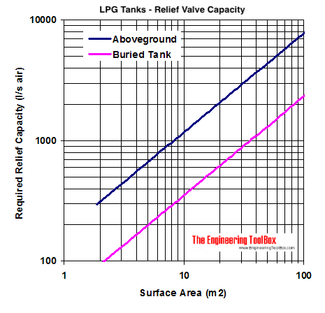

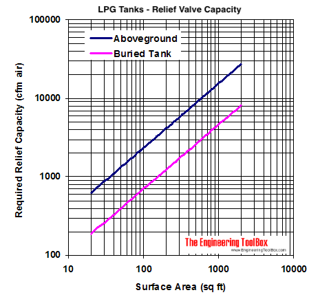

Required capacities of relief valves on LPG vaporizers and tanks.
The diagrams below indicates required capacity for relief valves on LPG - Liquefied Petroleum Gas - tanks above and below ground and vaporizers.
Area - square feet (ft2) - Flow rate - cfm air
lpg tank vaporizer relief valve capacity diagram
Area - m2 - Flow rate - l/s air
