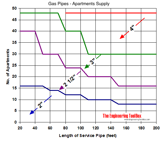

Sizing gas pipes for apartment service lines.
With more than one consumer supplied from a service pipe a diversity in consumption as indicated below can be expected:

- 1 ft (foot) = 0.3048 m
The table is based on schedule 40 steel pipe and can be used for a low pressure services lines with pressure head 6 inH2O and gas with 0.6 specific gravity and pressure drop 0.3 inH2O.
