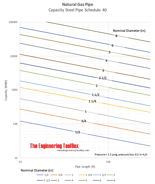

The tables below can be used for natural gas pipe sizing.
Steel Pipe - Schedule 40
Natural Gas - Low Pressure Capacities - Steel Pipes - Schedule 40
Pipe Size (in)Capacity of Pipe (MBH ≈ CFH)
Pipe Length (ft)
NominalInside diameter10204080150300
1/2 0.622 120 85 60 42 31 22
3/4 0.824 272 192 136 96 70 50
1 1.049 547 387 273 193 141 100
1 1/4 1.380 1200 849 600 424 310 219
1 1/2 1.610 1860 1316 930 658 480 340
2 2.067 3759 2658 1880 1330 971 686
2 1/2 2.469 6169 4362 3084 2189 1593 1126
3 3.068 11225 7938 5613 3969 2898 2049
4 4.026 23479 16602 11740 8301 6062 4287
5 5.047 42945 30367 21473 15183 11088 7841
6 6.065 69671 49265 34836 24632 17989 12720
8 7.981 141832 100290 70916 50145 36621 25895
natural gas pipe capacity diagram - MBH, psi and ft
  • pressure less than 1 1/2 psig
  • common to use fittings factor 1.5 - equivalent pipe length in table above = pipe length + 50%
  • pressure drop 0.5 inches water column
  • specific gravity of natural gas 0.6
  • One MBH is equivalent to 1000 BTU's per hour (0.29 kW = 0.29 kJ/s)
  • energy content in natural gas 1000 Btu/ft3 (37.26 MJ/m3)
  • steel pipes schedule 40
