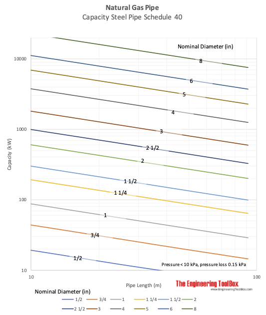

Natural gas pipe capacity diagram - kW, kPa and meter
  • pressure less than 10 kPa
  • fittings factor 1.5 - equivalent pipe length = pipe length + 50%
  • pressure drop 125 Pa
  • energy content in natural gas 37 MJ/m3
  • steel pipes schedule 40
