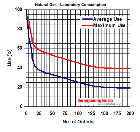

Natural gas consumption in laboratory outlets.
Due to diversity the average demand for natural gas outlets in laboratories can be estimated with the diagram below:
natural gas laboratory demand diagram
  • for laboratories in schools - in general no diversity for entire rooms
  • for industrial installations - be aware that there may be no diversity since equipment like boilers, heaters and similar may be used at the same time
