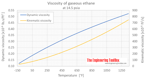

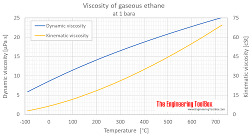

Dynamic and kinematic viscosity of gaseous ethane at atmospheric pressure and varying temperature:
Ethane viscosity gas 1 bara C
Ethane viscosity gas 1 bara F

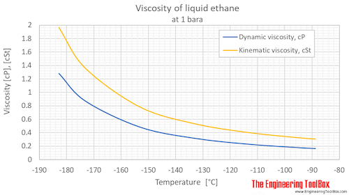

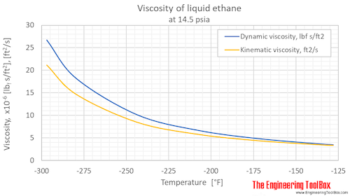

Dynamic and kinematic viscosity of liquid ethane at atmospheric pressure and varying temperature:
Ethane viscosity liquid 1 bara C
Ethane viscosity liquid 1 bara F

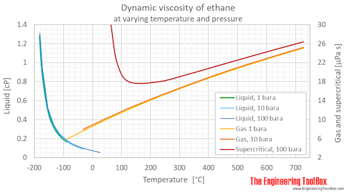

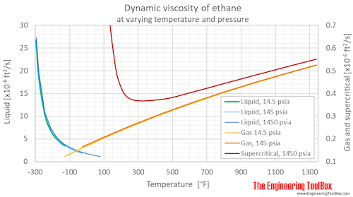

Dynamic viscosity of ethane at varying temperature and 1, 10 and 100 bara (14.5, 145 and 1450 psia):
Ethane dynamic viscosity pressure C
Ethane dynamic viscosity pressure F

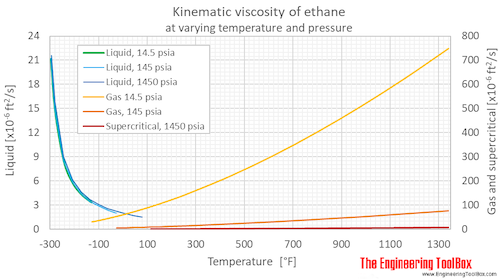

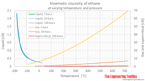

Kinematic viscosity of ethane at varying temperature and 1, 10 and 100 bara (14.5, 145 and 1450 psia):
Ethane kinematic viscosity pressure C
Ethane kinematic viscosity pressure F

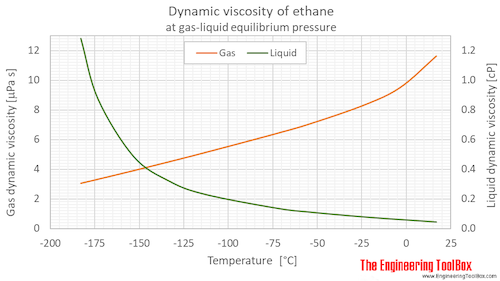

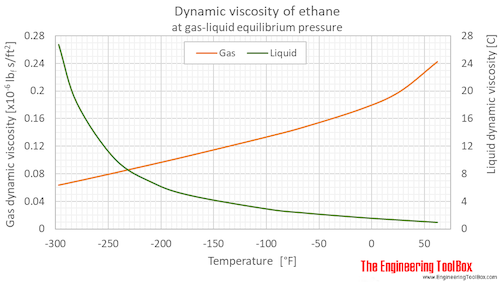

Dynamic viscosity of ethane  at gas-liquid equilibrium pressure:
Ethane dynamic viscosity equilibrium C
Ethane dynamic viscosity equilibrium F

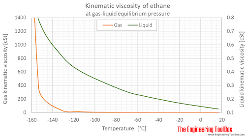

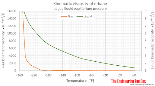

Kinematic viscosity of ethane  at gas-liquid equilibrium pressure:
Ethane kinematic viscosity equilibrium C
Ethane kinematic viscosity equilibrium F

90.368 -182.78 -297.01 1.14E-05 1.65E-04 1281 1.281 26.75 860.7 3.098 1.966 21.16
100 -173 -280 1.10E-04 0.00161 873.2 0.8732 18.24 586.8 2.112 1.362 14.66
120 -153 -244 0.00352 0.05110 485.8 0.4858 10.15 326.4 1.175 0.7848 8.448
140 -133 -208 0.03814 1.398 319.8 0.3198 6.679 214.9 0.7736 0.5360 5.770
160 -113 -172 0.2141 6.210 231.2 0.2312 4.828 155.3 0.5592 0.4030 4.338
200 -73.2 -99.7 2.172 31.51 138.3 0.1383 2.888 92.91 0.3345 0.2639 2.840
220 -53.2 -63.7 4.921 71.37 110.1 0.1101 2.298 73.95 0.2662 0.2218 2.387
250 -23.2 -9.7 13.01 188.7 78.19 0.07819 1.633 52.54 0.1891 0.1745 1.878
270 -3.1 26.3 22.10 320.5 60.94 0.060936 1.273 40.95 0.1474 0.1495 1.609
290 16.9 62.3 35.16 509.9 44.60 0.044603 0.9316 29.97 0.1079 0.1270 1.366
Gas at
equilibrium
90.368 -182.78 -297.01 1.14E-05 1.65E-04 3.043 0.003043 0.0635 2.045 0.00736 66566 716512
100 -173 -280 1.10E-04 0.00161 3.316 0.003316 0.06925 2.228 0.00802 8274 89059
120 -153 -244 0.00352 0.05110 3.896 0.003896 0.08137 2.618 0.00943 366.8 3948
140 -133 -208 0.03814 1.398 4.496 0.004496 0.09389 3.021 0.01088 45.50 489.8
160 -113 -172 0.2141 6.21 5.110 0.005110 0.1067 3.434 0.01236 10.449 112.5
200 -73.2 -99.7 2.172 31.51 6.391 0.006391 0.1335 4.294 0.01546 1.532 16.49
220 -53.2 -63.7 4.921 71.4 7.089 0.007089 0.1481 4.764 0.01715 0.7861 8.462
250 -23.2 -9.7 13.01 188.7 8.342 0.008342 0.1742 5.606 0.02018 0.3536 3.806
270 -3.1 26.3 22.10 320.5 9.526 0.009526 0.1989 6.401 0.02304 0.2263 2.436
290 16.9 62.3 35.16 509.9 11.62 0.01162 0.2426 7.806 0.02810 0.1504 1.619
Liquid 90.38 -182.77 -296.99 1 14.5 1281 1.281 26.75 860.8 3.099 1.966 21.16
100 -173 -280 1 14.5 873.9 0.8739 18.25 587.2 2.114 1.363 14.67
120 -153 -244 1 14.5 486.1 0.4861 10.15 326.6 1.176 0.7853 8.453
140 -133 -208 1 14.5 320.0 0.3200 6.683 215.0 0.7741 0.5364 5.773
160 -113 -172 1 14.5 231.3 0.2313 4.831 155.4 0.5595 0.4032 4.340
180 -93.2 -136 1 14.5 176.2 0.1762 3.680 118.4 0.4262 0.3207 3.451
184.33 -88.82 -127.88 1 14.5 166.9 0.1669 3.486 112.2 0.4037 0.3067 3.302
Gas 184.33 -88.82 -127.88 1 14.5 5.877 0.005877 0.1227 3.949 0.01422 2.895 31.16
200 -73.2 -99.7 1 14.5 6.368 0.006368 0.1330 4.279 0.01540 3.431 36.93
220 -53.2 -63.7 1 14.5 6.991 0.006991 0.1460 4.698 0.01691 4.171 44.90
240 -33.2 -27.7 1 14.5 7.608 0.007608 0.1589 5.112 0.01840 4.976 53.56
260 -13.2 8.3 1 14.5 8.217 0.008217 0.1716 5.522 0.01988 5.840 62.86
280 6.9 44.3 1 14.5 8.817 0.008817 0.1841 5.925 0.02133 6.767 72.84
300 26.9 80.3 1 14.5 9.408 0.009408 0.1965 6.322 0.02276 7.750 83.42
320 46.9 116 1 14.5 9.989 0.009989 0.2086 6.712 0.02416 8.785 94.57
340 66.9 152 1 14.5 10.56 0.01056 0.2206 7.096 0.02555 9.878 106.330
360 86.9 188 1 14.5 11.12 0.01112 0.2322 7.472 0.02690 11.02 118.627
400 127 260 1 14.5 12.21 0.01221 0.2550 8.205 0.02954 13.47 144.951
500 227 440 1 14.5 14.78 0.01478 0.3087 9.932 0.03575 20.41 219.677
600 327 620 1 14.5 17.13 0.01713 0.3578 11.51 0.04144 28.40 305.730
700 427 800 1 14.5 19.32 0.01932 0.4035 12.98 0.04674 37.39 402.474
800 527 980 1 14.5 21.36 0.02136 0.4461 14.35 0.05167 47.26 508.666
900 627 1160 1 14.5 23.28 0.02328 0.4862 15.64 0.05632 57.94 623.653
1000 727 1340 1 14.5 25.10 0.02510 0.5242 16.87 0.06072 69.41 747.162
Liquid 90.53 -182.62 -296.72 10 145 1283 1.283 26.80 862.1 3.104 1.969 21.19
100 -173 -280 10 145 880.2 0.8802 18.38 591.5 2.129 1.373 14.77
120 -153 -244 10 145 489.1 0.4891 10.22 328.7 1.183 0.7896 8.500
140 -133 -208 10 145 322.0 0.3220 6.725 216.4 0.7789 0.5392 5.804
160 -113 -172 10 145 232.8 0.2328 4.862 156.4 0.5632 0.4054 4.363
180 -93.2 -136 10 145 177.5 0.1775 3.707 119.3 0.4294 0.3225 3.471
200 -73.2 -99.7 10 145 139.3 0.1393 2.909 93.61 0.3370 0.2654 2.857
220 -53.2 -63.7 10 145 110.7 0.1107 2.312 74.39 0.2678 0.2227 2.397
240 -33.2 -27.7 10 145 87.85 0.08785 1.835 59.03 0.2125 0.1888 2.032
241.1 -32.1 -25.7 10 145 86.70 0.0867 1.811 58.26 0.2097 0.1871 2.013
Gas 241.1 -32.1 -25.7 10 145 7.929 0.007929 0.1656 5.328 0.01918 0.4395 4.731
260 -13.2 8.3 10 145 8.485 0.008485 0.1772 5.702 0.02053 0.5326 5.733
280 6.9 44.3 10 145 9.072 0.009072 0.1895 6.096 0.02195 0.6335 6.819
300 26.9 80.3 10 145 9.652 0.009652 0.2016 6.486 0.02335 0.7385 7.949
320 46.9 116 10 145 10.22 0.01022 0.2134 6.868 0.02472 0.8481 9.129
340 66.9 152 10 145 10.79 0.01079 0.2254 7.251 0.02610 0.9625 10.36
360 86.9 188 10 145 11.34 0.01134 0.2368 7.620 0.02743 1.081 11.64
400 127 260 10 145 12.42 0.01242 0.2594 8.346 0.03005 1.334 14.36
500 227 440 10 145 14.95 0.01495 0.3122 10.05 0.03617 2.042 21.97
600 327 620 10 145 17.29 0.01729 0.3611 11.62 0.04183 2.854 30.72
700 427 800 10 145 19.46 0.01946 0.4064 13.08 0.04708 3.762 40.49
800 527 980 10 145 21.48 0.02148 0.4486 14.43 0.05196 4.754 51.17
900 627 1160 10 145 23.39 0.02339 0.4885 15.72 0.05658 5.831 62.77
1000 727 1340 10 145 25.20 0.0252 0.5263 16.93 0.06096 6.984 75.18
Liquid 100 -173 -280 50 725 909.2 0.9092 18.99 610.9 2.199 1.414 15.22
200 -73.2 -99.7 50 725 144.7 0.1447 3.022 97.23 0.3500 0.2733 2.941
300 26.9 80.3 50 725 39.65 0.039648 0.8281 26.64 0.09591 0.1209 1.301
Supercritical
phase
400 127 260 50 725 13.91 0.013905 0.2904 9.344 0.03364 0.2620 2.820
500 227 440 50 725 16.00 0.015995 0.3341 10.75 0.03869 0.4166 4.484
600 327 620 50 725 18.12 0.018124 0.3785 12.18 0.04384 0.5883 6.333
Liquid 91.96 -181.19 -294.14 100 1450 1310 1.310 27.36 880.3 3.169 2.005 21.58
100 -173 -280 100 1450 947.3 0.9473 19.78 636.6 2.292 1.469 15.81
120 -153 -244 100 1450 520.6 0.5206 10.87 349.8 1.259 0.8348 8.986
140 -133 -208 100 1450 342.0 0.3420 7.143 229.8 0.8273 0.5679 6.113
160 -113 -172 100 1450 248.1 0.2481 5.182 166.7 0.6002 0.4275 4.601
180 -93.2 -136 100 1450 190.5 0.1905 3.979 128.0 0.4608 0.3413 3.674
200 -73.2 -99.7 100 1450 151.3 0.1513 3.160 101.7 0.3660 0.2829 3.045
220 -53.2 -63.7 100 1450 122.4 0.1224 2.556 82.25 0.2961 0.2399 2.582
240 -33.2 -27.7 100 1450 99.96 0.09996 2.088 67.17 0.2418 0.2066 2.224
260 -13.2 8.3 100 1450 81.74 0.08174 1.707 54.93 0.1977 0.1798 1.935
280 6.9 44.3 100 1450 66.38 0.06638 1.386 44.61 0.1606 0.1575 1.696
300 26.9 80.3 100 1450 52.87 0.05287 1.104 35.53 0.1279 0.1387 1.492
Supercritical
phase
320 46.9 116 100 1450 40.36 0.04036 0.8429 27.12 0.09763 0.1227 1.321
340 66.9 152 100 1450 28.77 0.02877 0.6009 19.33 0.06960 0.1124 1.210
360 86.9 188 100 1450 21.62 0.02162 0.4515 14.53 0.05230 0.1156 1.244
400 127 260 100 1450 17.94 0.01794 0.3747 12.06 0.04340 0.1422 1.530
500 227 440 100 1450 17.95 0.01795 0.3749 12.06 0.04342 0.2228 2.398
600 327 620 100 1450 19.50 0.0195 0.4073 13.10 0.04717 0.3124 3.363
700 427 800 100 1450 21.26 0.02126 0.4440 14.29 0.05143 0.4105 4.419
800 527 980 100 1450 23.01 0.02301 0.4806 15.46 0.05566 0.5160 5.555
900 627 1160 100 1450 24.73 0.02473 0.5165 16.62 0.05982 0.6293 6.773
1000 727 1340 100 1450 26.40 0.0264 0.5514 17.74 0.06386 0.7500 8.073
Liquid 100 -173 -280 300 4351 1127 1.127 23.54 757.5 2.727 1.729 18.61
200 -73.2 -99.7 300 4351 177.0 0.17704 3.698 119.0 0.4283 0.3205 3.450
300 26.9 80.3 300 4351 77.61 0.07761 1.621 52.15 0.1877 0.1746 1.879
Supercritical
phase
400 127 260 300 4351 42.22 0.042216 0.8817 28.37 0.1021 0.1298 1.398
500 227 440 300 4351 30.51 0.03051 0.6372 20.50 0.07381 0.1321 1.422
600 327 620 300 4351 27.54 0.027539 0.5752 18.51 0.06662 0.1554 1.673
Liquid 200 -73.2 -99.7 700 10153 230.7 0.2307 4.818 155.0 0.5581 0.3990 4.294
300 26.9 80.3 700 10153 113.5 0.11352 2.371 76.28 0.2746 0.2283 2.457
Supercritical
phase
400 127 260 700 10153 71.77 0.071766 1.499 48.22 0.1736 0.1701 1.831
500 227 440 700 10153 52.33 0.052331 1.093 35.16 0.1266 0.1466 1.578
600 327 620 700 10153 44.74 0.044741 0.9344 30.06 0.1082 0.1467 1.579
