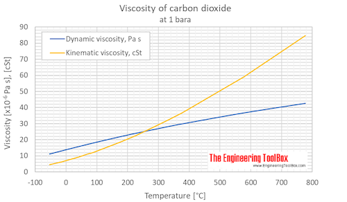

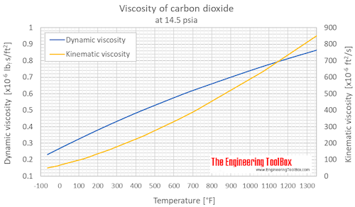

Dynamic and kinematic viscosity of carbon dioxide at atmospheric pressure and varying temperature:
Carbon dioxide viscosity 1 bara C
Carbon dioxide viscosity 1 bara F

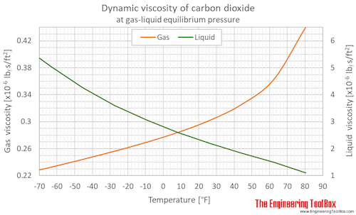

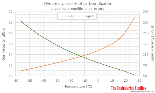

Dynamic viscosity of carbon dioxide at gas-liquid equilibrium pressure:
Carbon dioxide dynamic viscosity equlibrium C Carbon dioxide dynamic viscosity equlibrium F

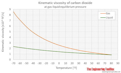

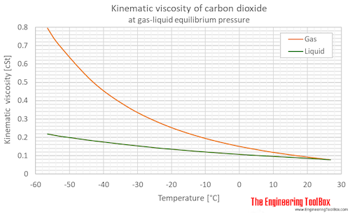

Kinematic viscosity of carbon dioxide at gas-liquid equilibrium pressure:
Carbon dioxide kinematic viscosity equlibrium C
Carbon dioxide kinematic viscosity equlibrium F

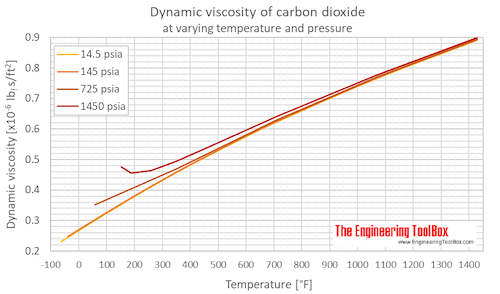

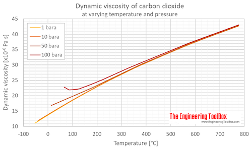

Dynamic viscosity of carbon dioxide at varying temperature and 1, 10, 50 and 100 bara (14.5, 145, 725 and 1450 psia):
Carbon dioxide dynamic viscosity pressure C

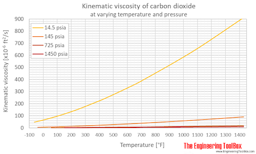

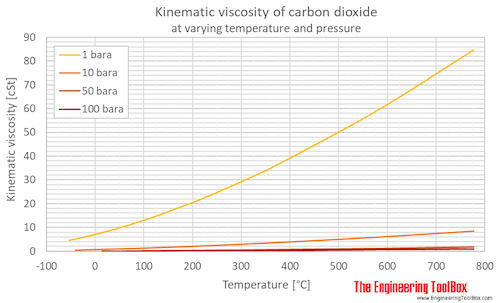

Carbon dioxide dynamic viscosity pressure F Kinematic viscosity of carbon dioxide at varying temperature and 1, 10, 50 and 100 bara (14.5, 145, 725 and 1450 psia):
Carbon dioxide kinematic viscosity pressure C
Carbon dioxide kinematic viscosity pressure F

State Temperature Pressure Dynamic (Absolute) Viscosity Kinematic Viscosity
[K] [°C] [°F] [bara] [psia] [μPa s] [cP] [lbf s/ft2*10-6 ] [lbm /ft s*10-6 ] [lbm /ft h] [cSt],
[m2/s*10-6 ]
[ft2/s*10-6 ]
Liquid at
equilibrium
216.59 -56.56 -69.81 5.18 75.1 256.7 0.2567 5.361 172.5 0.6210 0.2178 2.345
220 -53.2 -63.7 5.99 86.9 242.0 0.2420 5.054 162.6 0.5854 0.2075 2.234
230 -43.2 -45.7 8.93 130 204.2 0.2042 4.265 137.2 0.4941 0.1809 1.948
240 -33.2 -27.7 12.8 186 173.0 0.1730 3.612 116.2 0.4184 0.1588 1.710
250 -23.2 -9.7 17.9 259 146.7 0.1467 3.065 98.60 0.3550 0.1403 1.510
260 -13.2 8.3 24.2 351 124.4 0.1244 2.598 83.59 0.3009 0.1245 1.341
270 -3.1 26.3 32.0 465 105.0 0.1050 2.193 70.57 0.2541 0.1110 1.195
280 6.9 44.3 41.6 603 87.73 0.08773 1.832 58.95 0.2122 0.09929 1.069
290 16.9 62.3 53.2 771 71.41 0.07141 1.491 47.98 0.1727 0.08874 0.9552
300 26.9 80.3 67.1 974 53.11 0.05311 1.109 35.69 0.1285 0.07819 0.8416
Gas at
equilibrium
216.59 -56.56 -69.81 5.18 75.1 10.95 0.01095 0.2287 7.359 0.02649 0.7958 8.566
220 -53.2 -63.7 5.99 86.9 11.14 0.01114 0.2326 7.482 0.02694 0.7040 7.577
230 -43.2 -45.7 8.93 130 11.69 0.01169 0.2441 7.855 0.02828 0.5023 5.407
240 -33.2 -27.7 12.8 186 12.27 0.01227 0.2563 8.246 0.02969 0.3686 3.967
250 -23.2 -9.7 17.9 259 12.90 0.01290 0.2695 8.670 0.03121 0.2766 2.977
260 -13.2 8.3 24.2 351 13.61 0.01361 0.2843 9.148 0.03293 0.2113 2.275
270 -3.1 26.3 32.0 465 14.47 0.01447 0.3022 9.723 0.03500 0.1637 1.762
280 6.9 44.3 41.6 603 15.60 0.01560 0.3258 10.48 0.03774 0.1281 1.379
290 16.9 62.3 53.2 771 17.36 0.01736 0.3625 11.66 0.04199 0.1009 1.086
300 26.9 80.3 67.1 974 21.06 0.02106 0.4398 14.15 0.05095 0.07841 0.8440
Gas 220 -53.2 -63.7 1 14.5 11.06 0.01106 0.2310 7.432 0.02676 4.535 48.81
240 -33.2 -27.7 1 14.5 12.07 0.01207 0.2521 8.111 0.02920 5.417 58.31
250 -23.2 -9.7 1 14.5 12.57 0.01257 0.2624 8.443 0.03040 5.882 63.31
260 -13.2 8.3 1 14.5 13.06 0.01306 0.2728 8.776 0.03159 6.365 68.51
280 6.9 44.3 1 14.5 14.05 0.01405 0.2934 9.441 0.03399 7.387 79.51
300 26.9 80.3 1 14.5 15.02 0.01502 0.3137 10.09 0.03633 8.472 91.19
320 46.9 116 1 14.5 15.98 0.01598 0.3337 10.74 0.03866 9.621 103.6
340 66.9 152 1 14.5 16.93 0.01693 0.3536 11.38 0.04096 10.84 116.7
360 86.9 188 1 14.5 17.87 0.01787 0.3732 12.01 0.04323 12.12 130.5
400 127 260 1 14.5 19.70 0.01970 0.4114 13.24 0.04766 14.86 159.9
450 177 350 1 14.5 21.90 0.02190 0.4574 14.72 0.05298 18.72 201.5
500 227 440 1 14.5 24.02 0.02402 0.5017 16.14 0.05811 22.68 244.1
600 327 620 1 14.5 28.00 0.02800 0.5848 18.82 0.06773 31.73 341.6
650 377 710 1 14.5 29.87 0.02987 0.6239 20.07 0.07227 36.68 394.8
850 577 1070 1 14.5 36.71 0.03671 0.7666 24.67 0.08880 58.95 634.6
1050 777 1430 1 14.5 42.69 0.04269 0.8916 28.69 0.1033 84.71 911.8
Liquid 216.7 -56.5 -69.6 10 145 257.2 0.2572 5.372 172.8 0.6222 0.2182 2.348
220 -53.2 -63.7 10 145 242.8 0.2428 5.071 163.2 0.5874 0.2081 2.239
233.03 -40.1 -40.2 10 145 194.1 0.1941 4.054 130.4 0.4695 0.1738 1.870
Gas 233.03 -40.1 -40.2 10 145 11.86 0.01186 0.2477 7.970 0.02869 0.4560 4.908
240 -33.2 -27.7 10 145 12.20 0.01220 0.2548 8.198 0.02951 0.4907 5.282
250 -23.2 -9.7 10 145 12.69 0.01269 0.2651 8.528 0.03070 0.5415 5.829
260 -13.2 8.3 10 145 13.18 0.01318 0.2753 8.857 0.03188 0.5934 6.388
280 6.9 44.3 10 145 14.15 0.01415 0.2955 9.508 0.03423 0.7005 7.540
300 26.9 80.3 10 145 15.11 0.01511 0.3156 10.15 0.03655 0.8132 8.754
320 46.9 116 10 145 16.07 0.01607 0.3356 10.80 0.03887 0.9327 10.04
340 66.9 152 10 145 17.01 0.01701 0.3553 11.43 0.04115 1.057 11.38
360 86.9 188 10 145 17.94 0.01794 0.3747 12.06 0.04340 1.187 12.78
400 127 260 10 145 19.76 0.01976 0.4127 13.28 0.04780 1.466 15.78
450 177 350 10 145 21.95 0.02195 0.4585 14.75 0.05311 1.845 19.86
500 227 440 10 145 24.06 0.02406 0.5025 16.17 0.05820 2.257 24.29
600 327 620 10 145 28.04 0.02804 0.5856 18.84 0.06783 3.170 34.12
650 377 710 10 145 29.91 0.02991 0.6246 20.10 0.07235 3.668 39.48
850 577 1070 10 145 36.73 0.03673 0.7672 24.68 0.08886 5.906 63.58
1050 777 1430 10 145 42.71 0.04271 0.8921 28.70 0.1033 8.491 91.40
Liquid 250 -23.2 -9.7 50 725 153.2 0.15315 3.199 102.9 0.370 0.14464 1.557
287.43 14.28 57.70 50 725 75.60 0.07560 1.579 50.80 0.183 0.09138 0.9836
Gas 287.43 14.28 57.70 50 725 16.81 0.01681 0.3510 11.29 0.041 0.10728 1.1548
450 177 350 50 725 22.43 0.02243 0.4684 15.07 0.054 0.36004 3.875
650 377 710 50 725 30.16 0.03016 0.6298 20.26 0.073 0.73696 7.933
850 577 1070 50 725 36.90 0.03690 0.7707 24.79 0.089 1.194 12.85
1050 777 1430 50 725 42.84 0.04284 0.8946 28.78 0.104 1.718 18.49
Liquid 218.6 -54.55 -66.19 100 1450 266.3 0.2663 5.562 178.9 0.644 0.224 2.41
220 -53.2 -63.7 100 1450 260.2 0.2602 5.434 174.8 0.629 0.2194 2.362
240 -33.2 -27.7 100 1450 189.4 0.1894 3.956 127.3 0.458 0.1699 1.828
250 -23.2 -9.7 100 1450 162.5 0.16247 3.393 109.2 0.393 0.1509 1.625
260 -13.2 8.3 100 1450 139.5 0.1395 2.914 93.74 0.337 0.1348 1.451
280 6.9 44.3 100 1450 102.2 0.1022 2.134 68.68 0.247 0.1093 1.176
300 26.9 80.3 100 1450 71.03 0.07103 1.483 47.73 0.172 0.08861 0.9538
Supercritical
phase
320 46.9 116 100 1450 32.39 0.03239 0.6765 21.77 0.07835 0.07225 0.7777
340 66.9 152 100 1450 22.80 0.02280 0.4762 15.32 0.05516 0.08817 0.9490
360 86.9 188 100 1450 21.83 0.02183 0.4559 14.67 0.05281 0.1049 1.129
400 127 260 100 1450 22.23 0.02223 0.4643 14.94 0.05378 0.1376 1.482
450 177 350 100 1450 23.68 0.02368 0.4945 15.91 0.05728 0.1799 1.936
500 227 440 100 1450 25.39 0.02539 0.5303 17.06 0.06142 0.2245 2.416
600 327 620 100 1450 28.94 0.02894 0.6044 19.45 0.07001 0.3218 3.464
650 377 710 100 1450 30.69 0.03069 0.6409 20.62 0.07423 0.3742 4.028
850 577 1070 100 1450 37.22 0.03722 0.7774 25.01 0.09005 0.6072 6.536
1050 777 1430 100 1450 43.07 0.04307 0.8995 28.94 0.104 0.8733 9.400
