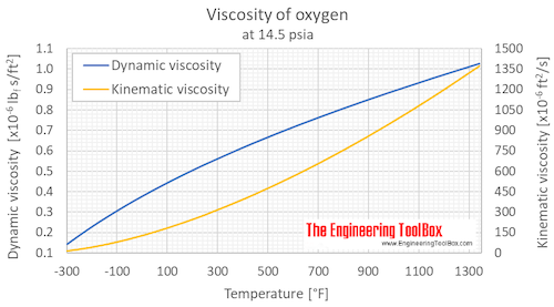

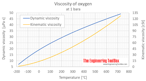

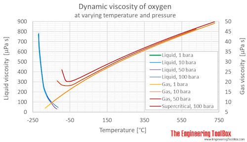

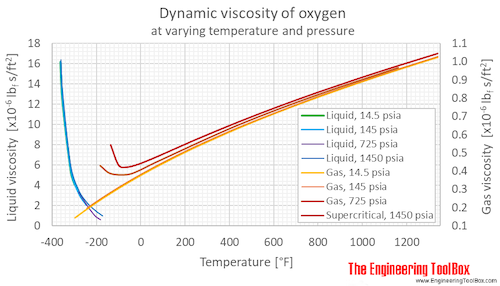

Oxygen dynamic and kinematic viscosity at atmospheric pressure and varying temperature:
Oxygen  viscosity 1 bara C Oxygen  viscosity 1 bara F
Dynamic viscosity of oxygen at varying temperature and 1, 10, 50 and 100 bara (14.5, 145, 725 and 1450 psia):
Oxygen dynamic viscosity pressure C
Oxygen dynamic viscosity pressure F

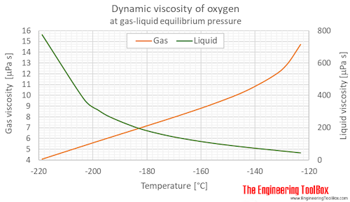

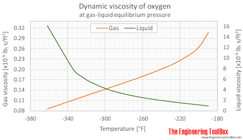

Dynamic viscosity of oxygen at gas-liquid equilibrium pressure: Oxygen dynamic viscosity equilibrium C
Oxygen dynamic viscosity equilibrium F

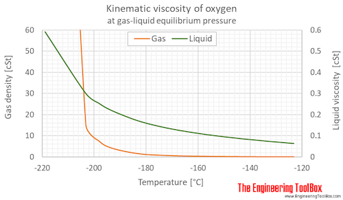

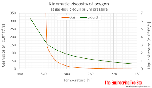

Kinematic viscosity of oxygen at gas-liquid equilibrium pressure:
Oxygen kinematic viscosity equilibrium C
Oxygen kinematic viscosity equilibrium F

54.361 -218.79 -361.82 0.0015 0.0212 773.62 0.7736 16.16 519.8 1.871 0.5923 6.376
70 -203 -334 0.0626 0.908 371.79 0.3718 7.765 249.8 0.8994 0.3006 3.235
75 -198 -325 0.145 2.11 308.66 0.3087 6.446 207.4 0.7467 0.2543 2.737
80 -193 -316 0.301 4.37 261.22 0.2612 5.456 175.5 0.6319 0.2194 2.362
90 -183 -298 0.994 14.4 195.64 0.1956 4.086 131.5 0.4733 0.1713 1.844
100 -173 -280 2.54 36.8 152.56 0.1526 3.186 102.5 0.3691 0.1398 1.505
110 -163 -262 5.43 78.8 121.52 0.1215 2.538 81.66 0.2940 0.1174 1.263
120 -153 -244 10.2 148.3 97.43 0.09743 2.035 65.47 0.2357 0.1000 1.077
130 -143 -226 17.5 253.7 77.57 0.07757 1.620 52.13 0.1877 0.08595 0.9252
140 -133 -208 27.9 404.3 60.22 0.06022 1.258 40.47 0.1457 0.07405 0.7971
145 -128 -199 34.5 500.0 51.87 0.05187 1.083 34.85 0.1255 0.06869 0.7393
150 -123 -190 42.2 611.9 42.90 0.04290 0.8960 28.83 0.1038 0.06351 0.6836
Gas at
equilibrium
54.361 -218.79 -361.82 0.0015 0.0212 4.096 0.00410 0.08555 2.753 0.00991 395.4 4257
70 -203 -334 0.0626 0.908 5.356 0.0053557 0.1119 3.599 0.01296 15.49 166.7
75 -198 -325 0.145 2.11 5.753 0.0057533 0.1202 3.866 0.01392 7.648 82.32
80 -193 -316 0.301 4.37 6.149 0.0061486 0.1284 4.132 0.01487 4.187 45.07
90 -183 -298 0.994 14.4 6.936 0.0069355 0.1449 4.660 0.01678 1.581 17.02
100 -173 -280 2.54 36.8 7.728 0.0077281 0.1614 5.193 0.01869 0.7413 7.979
110 -163 -262 5.43 78.8 8.547 0.0085467 0.1785 5.743 0.02068 0.4016 4.323
120 -153 -244 10.2 148.3 9.427 0.0094273 0.1969 6.335 0.02281 0.2398 2.581
130 -143 -226 17.5 253.7 10.45 0.01045 0.2181 7.019 0.02527 0.1528 1.644
140 -133 -208 27.9 404.3 11.82 0.01182 0.2469 7.945 0.02860 0.1013 1.090
145 -128 -199 34.5 500.0 12.88 0.01288 0.2690 8.656 0.03116 0.08315 0.8950
150 -123 -190 42.2 611.9 14.72 0.01472 0.3075 9.892 0.03561 0.06849 0.7372
Liquid 54.37 -218.8 -361.8 1 14.5 773.8 0.7738 16.16 520.0 1.872 0.5925 6.378
60 -213 -352 1 14.5 578.5 0.5785 12.08 388.7 1.399 0.4512 4.857
80 -193 -316 1 14.5 261.4 0.2614 5.459 175.7 0.6323 0.2195 2.362
90.06 -183.09 -297.56 1 14.5 195.3 0.1953 4.079 131.2 0.4724 0.1710 1.841
Gas
90.06 -183.09 -297.56 1 14.5 6.940 0.00694 0.1449 4.663 0.01679 1.573 16.93
100 -173 -280 1 14.5 7.712 0.007712 0.1611 5.182 0.01866 1.957 21.06
120 -153 -244 1 14.5 9.219 0.009219 0.1925 6.195 0.02230 2.835 30.51
140 -133 -208 1 14.5 10.67 0.01067 0.2228 7.170 0.02581 3.846 41.40
160 -113 -172 1 14.5 12.07 0.01207 0.2521 8.111 0.02920 4.988 53.69
180 -93.2 -136 1 14.5 13.41 0.01341 0.2801 9.011 0.03244 6.246 67.23
200 -73.2 -99.7 1 14.5 14.72 0.01472 0.3074 9.891 0.03561 7.627 82.10
220 -53.2 -63.7 1 14.5 15.98 0.01598 0.3337 10.74 0.03866 9.116 98.12
240 -33.2 -27.7 1 14.5 17.20 0.01720 0.3592 11.56 0.04161 10.71 115.3
260 -13.2 8.3 1 14.5 18.38 0.01838 0.3839 12.35 0.04446 12.40 133.5
280 6.9 44.3 1 14.5 19.53 0.01953 0.4079 13.12 0.04724 14.19 152.8
300 26.9 80.3 1 14.5 20.65 0.02065 0.4313 13.88 0.04995 16.08 173.1
320 46.9 116 1 14.5 21.74 0.02174 0.4540 14.61 0.05259 18.07 194.5
340 66.9 152 1 14.5 22.80 0.02280 0.4762 15.32 0.05516 20.14 216.8
360 86.9 188 1 14.5 23.84 0.02384 0.4979 16.02 0.05767 22.30 240.0
400 127 260 1 14.5 25.84 0.02584 0.5397 17.36 0.06251 26.86 289.1
500 227 440 1 14.5 30.49 0.03049 0.6368 20.49 0.07376 39.62 426.4
600 327 620 1 14.5 34.73 0.03473 0.7254 23.34 0.08401 54.16 582.9
700 427 800 1 14.5 38.65 0.03865 0.8072 25.97 0.09350 70.31 756.8
800 527 980 1 14.5 42.33 0.04233 0.8841 28.44 0.1024 88.02 947.5
900 627 1160 1 14.5 45.81 0.04581 0.9568 30.78 0.1108 107.2 1153.4
1000 727 1340 1 14.5 49.12 0.04912 1.026 33.01 0.1188 127.7 1374.0
