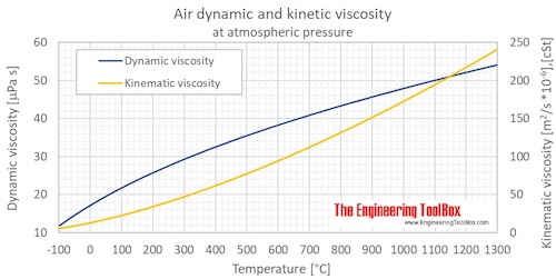

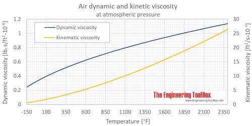

Air dynamic and kinematic viscosity at atmospheric pressure and varying temperature:
Air dynamic kinematic viscosity atm C Air dynamic kinematic viscosity atm F

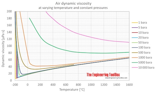

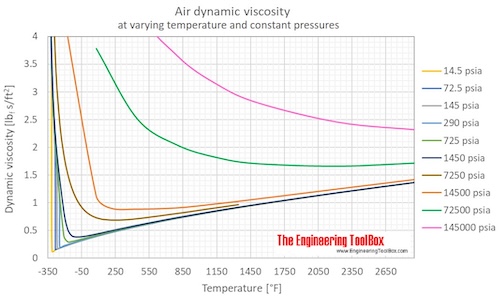

Air dynamic viscosity at varying temperature and constant pressures (1-10 000 bara, 14.5 - 145 000 psia):
Air Dynamic viscosity pressure C
Air Dynamic viscosity pressure F

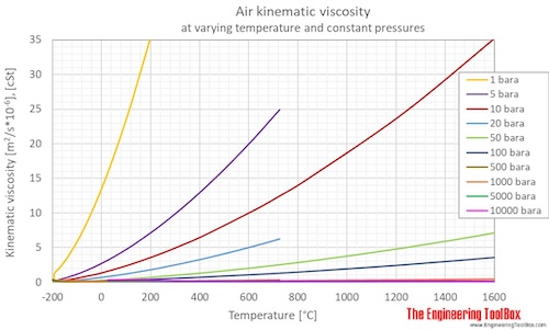

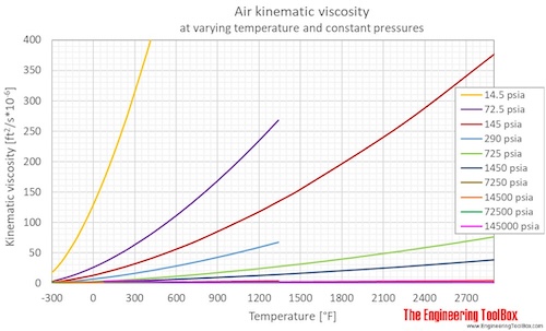

Air kinematic viscosity at varying temperature and constant pressures (1-10 000 bara, 14.5 - 145 000 psia):
Air Kinematic viscosity pressure C
Air Kinematic viscosity pressure F

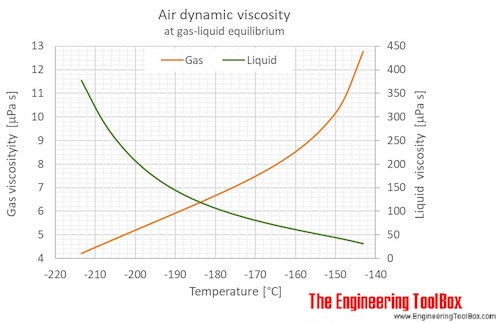

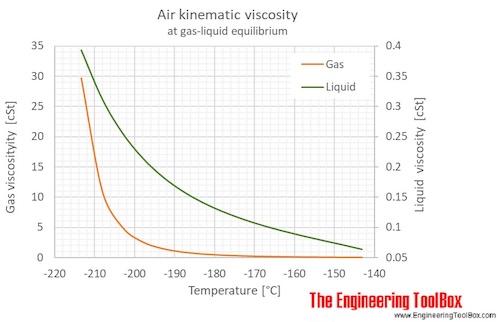

Air dynamic and kinematic viscosity at gas-liquid equilibrium pressure: Air Dynamic viscosity saturation pressure
Air kinematic viscosity saturation pressure
Dynamic (absolute) and kinematic viscosity of air at 1 atmosphere pressure, at temperatures given as °F:
