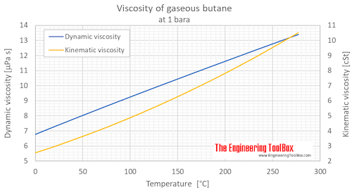

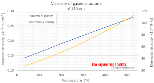

Dynamic and kinematic viscosity of gaseous butane at atmospheric pressure and varying temperature:
Butane viscosity gas 1 bara C
Butane viscosity gas 1 bara F

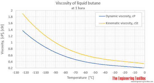

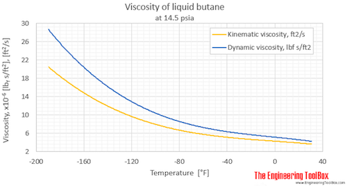

Dynamic and kinematic viscosity of liquid butane at atmospheric pressure and varying temperature:
Butane viscosity liquid 1 bara C
Butane viscosity liquid 1 bara F

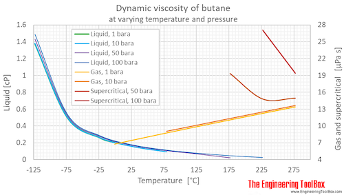

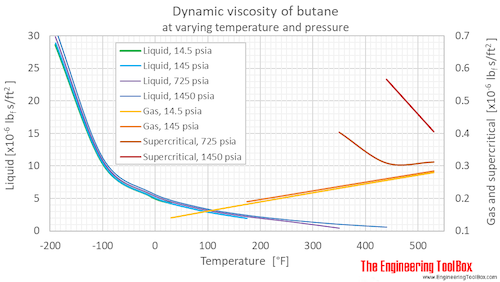

Dynamic viscosity of butane at varying temperature and 1, 10, 50 and 100 bara (14.5, 145, 725 and 1450 psia):
Butane dynamic viscosity pressure C
Butane dynamic viscosity pressure F

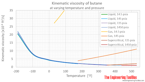

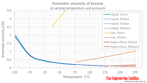

Kinematic viscosity of butane at varying temperature and 1, 10, 50 and 100 bara (14.5, 145, 725 and 1450 psia):
Butane kinematic viscosity pressure C
Butane kinematic viscosity pressure F

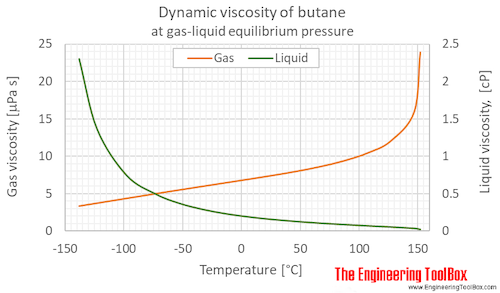

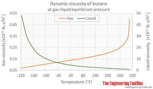

Dynamic viscosity of butane at gas-liquid equilibrium pressure:
Butane dynamic viscosity equilibrium C
Butane dynamic viscosity equilibrium F

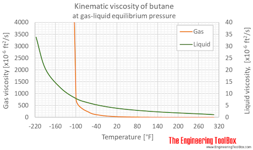

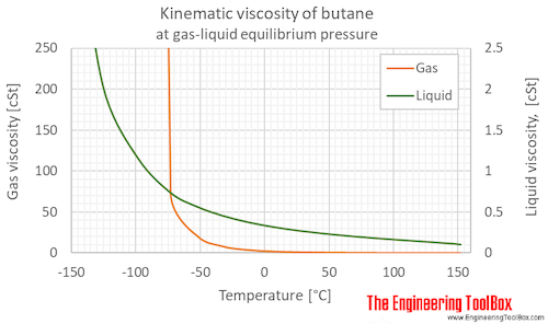

Kinematic viscosity of butane at gas-liquid equilibrium pressure:
Butane kinematic viscosity equilibrium C
Butane kinematic viscosity equilibrium F
