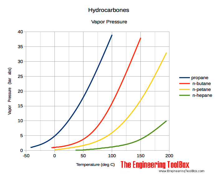

Hydrocarbons - Vapor Pressures
Vapor pressure vs. temperature for propane, n-butane, n-heptane and n-pentane hydrocarbons.
Vapor pressure versus temperature for the hydrocarbons propane, n-butane, n-pentane and n-heptane:
Vapor pressure versus temperature - hydrocarbones propane butane pentane heptane
