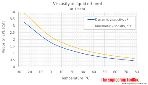

Dynamic and kinematic viscosity of liquid ethanol at atmospheric pressure and varying temperature:
Ethanol viscosity liquid 1 bara C
Ethanol viscosity liquid 1 bara F

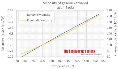

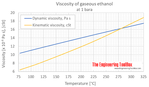

Dynamic and kinematic viscosity of gaseous ethanol at atmospheric pressure and varying temperature: Ethanol viscosity gas 1 bara C
Ethanol viscosity gas 1 bara F

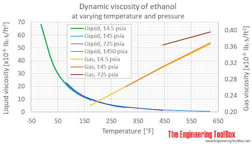

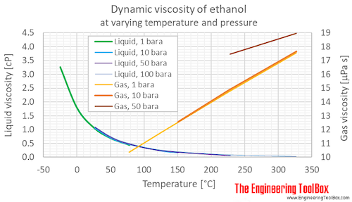

Dynamic viscosity of ethanol at varying temperature and 1, 10, 50 and 100 bara (14.5, 145, 725 and 1450 psia):
Ethanol dynamic viscosity pressure C
Ethanol dynamic viscosity pressure F

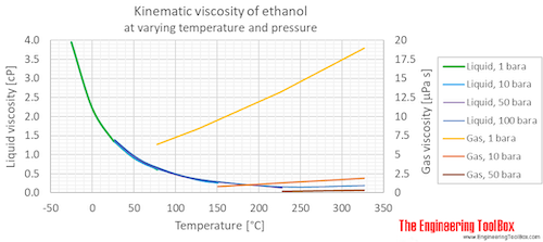

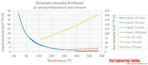

Kinematic viscosity of ethanol at varying temperature and 1, 10, 50 and 100 bara (14.5, 145, 725 and 1450 psia):
Ethanol kinematic viscosity pressure C
Ethanol kinematic viscosity pressure F

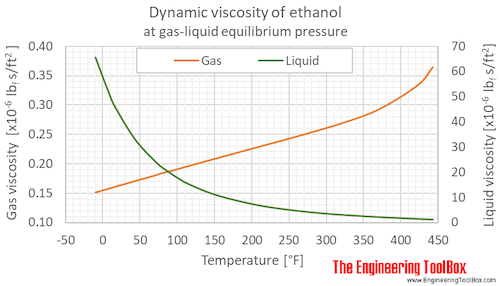

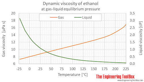

Dynamic viscosity of ethanol  at gas-liquid equilibrium pressure:
Ethanol dynamic viscosity equlibrium C
Ethanol dynamic viscosity equlibrium F

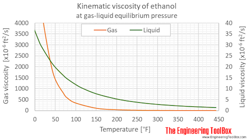

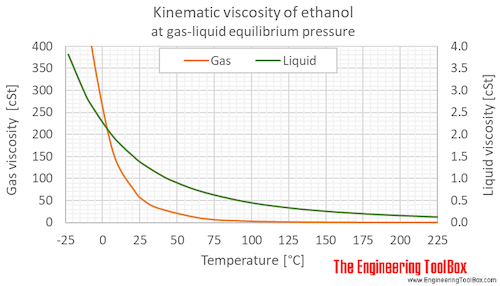

Kinematic viscosity of ethanol at gas-liquid equilibrium pressure:
Ethanol kinematic viscosity equlibrium C
Ethanol kinematic viscosity equlibrium F
