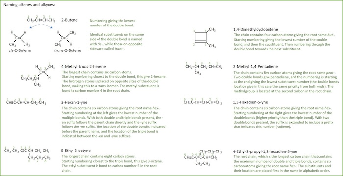

Alkenes and alkynes
Alkene: An unsaturated hydrocarbon that contains at least one carbon–carbon double bond, with the general formula C n H 2n (if only one double bond). Alkenes are also called olefin .
Alkyne:
An unsaturated hydrocarbon containing at least one carbon—carbon triple bond, with the general formula C n H 2n-2 (if only one triple bond). Alkynes are also called acetylenes .
Cycloalkene: An alkene hydrocarbon which contains a closed ring of carbon atoms, but has no aromatic character, with the general formula C n H 2n-2 . Also called cycloolefin .
The following rules are given to name alkanes and alkyne.
  1. Double bonds in hydrocarbons are indicated by replacing the name ending -ane with -ene . If there is more than one double bond, the ending is expanded to include a prefix that indicates the number of double bonds present ( - adiene, -atriene etc.).
  2. Triple bonds are named in a similar way using the ename ending -yne .
  3. The position of the multiple bonds within the root chain are indicated by placing the numbers of the first carbon of the multiple bonds directly in front of the base name.
  4. The root chain is numbered so that the multiple bonds have the lowest numbers (double and triple bonds have priority over alkyl and halo substituents).
  5. When both double and triple bonds are present, numbers as low as possible are given to double and triple bonds even though this may at times give -yne a lower number than -ene . When there is a choice in numbering, the double bonds are given the lowest numbers.
  6. When both double and triple bonds are present, the -en ending follows the root chain directly and the -yne ending follows the -en ending (notice that the e is left off, -en instead of -ene). The location of the double bonds are indicated before the parent name as before, and the location of the triple bonds are indicated between the -en and -yne suffixes.
  7. For a branched unsaturated acyclic hydrocarbon, the root chain is the longest carbon chain that contains the maximum number of double and triple bonds. If there are two or more chains competing for selection as the parent chain (chain with the most multiple bonds), the choice goes to
    1. The chain with the greatest number of carbon atoms,
    2. If the number of carbon atoms being equal, the chain containing the maximum number of double bonds.
  8. Alkenes with the R1 -CH=CH-R2unit can exist as cis- and trans- isomers. Identical substituents on the same side of the double bond is named with cis- , while those on opposite sides are called trans- .
  9. For cyclic alkenes, number through the double bond towards the substituent
  10. If there is a choice in numbering not previously covered, the parent chain is numbered to give the substituents the lowest number at the first point of difference.
naming alkenes and alkynes

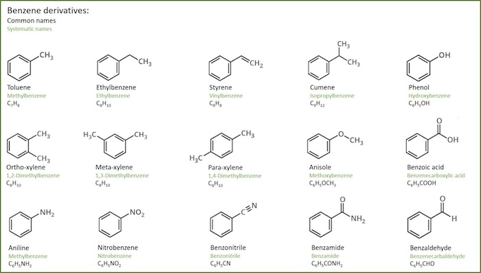

Aromatics
Aromatic hydrocarbon: A cyclic (ring-shaped), planar (flat) molecule with a ring of resonance bonds that exhibits more stability than other geometric or connective arrangements with the same set of atoms. The simplest of the aromatics have 6 carbon atoms and contains 3 double bounds.  A one ring aromatic without any substituents is called benzene, with the formula C6 H6 .
Phenyl: A phenyl group is a benzene ring missing one hydrogen, acting as a substituent, with general formula C6 H5.
The nomenclature of aromatics is similar to the nomeclature oof saturated ring systems:
  1. One way to name these is to use the benzene as the root and add the approriate substituent prefix.
  2. There are many common simple substituted benzenes with common names that are also used as part of the IUPAC system, examples are given below.
  3. When there are two (or more) substituents, the relative position of the subsituents must be defined.
  4. There are two methods used based on either numerical locants or specific words for the three possible forms:
    1. The terms ortho-, meta- or para- (or their singel letter equivalents) are used as prefixes.The words can also be shortened to their first letter, i.e. o-, m- and p-. T hese terms are ONLY used for benzene systems.
    2. When numerical locants are used, the principal functional group is defined to be at C1. The numerical locant method is also applicable to other aromatic systems.
benzene derivatives

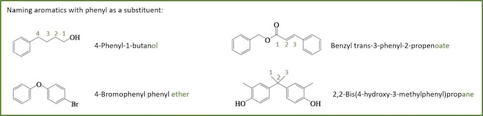

In some cases, the benzene ring needs to be treated as a substituent.
  1. In these cases, the term phenyl , is used to designate the presence of C6 H5 - as a substituent.
  2. Take care not to confuse terminology
    1. phenyl substituent = C6 H5-
    2. benzyl substituent = C6 H5 CH2-
    3. phenol a compound = C6 H5 OH
  3. The method should be used when the benzene ring is a substituent of the root (the root contains the principle functional group).
Phenyl naming

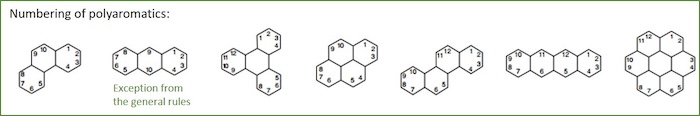

  4. Numbering begins with the uppermost ring the furthest to the right, with the most counterclockwise carbon atom not involved with ring fusion.
  5. The numbering proceeds clockwise around the structure with hydrogenated carbon atoms.
    1. The numbering of Anthracene is a "retained exception" to this rule.
numbering polyaromatics

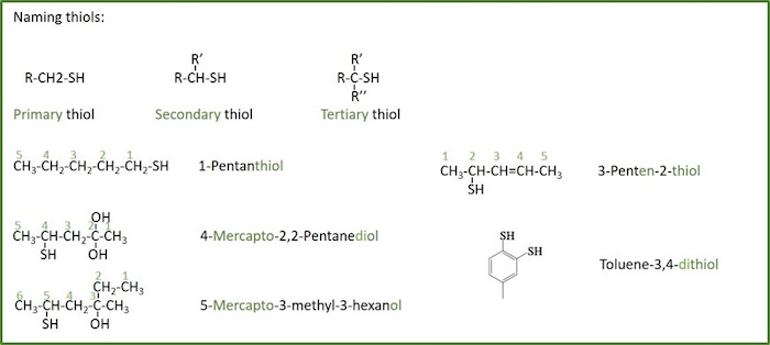

Thiols
Thiol: An organosulfur compound that contains a carbon-bonded sulfhydryl group (-SH), with the general formula R–SH (where R represents an alkyl or other organic substituent). Thiols are also called mercaptans.
Thiols can be seen as a sulfur analogue to alcohols (sulfur takes the place of oxygen in the hydroxyl group of an alcohol). As the alcohols, thiols are classified according to the number of hydrocarbon substituents bonded to the carbon where the -SH group is attached; primary, secondary and tertiary thiols.
Naming rules for thiols:
  1. Thiols are named by replacing the suffix -ane with -anthiol .
  2. If there is more than one sulfhydryl group (-SH), the suffix is expanded to include a prefix that indicates the number of hydroxyl groups present ( - anedithiol, -anetrithiol... ).
  3. The term sulfanyl- or mercapto- is used as a prefix.
  4. The position of the sulfhydryl group on the root chain is indicated by placing the number corresponding to the location on the root chain directly in front of the base name (same as alkenes ).
  5. The sulfhydryl group takes precedence after hydroxyl groups (alcohols), but over alkyl groups and halogen substituents, as well as double bonds, in the numbering of the root chain. For comparison with other groups, see table for functional groups priority.
  6. When both double bonds and sulfhydryl groups are present
    1. The -en suffix follows the root chain directly and the -thiol suffix follows the -en suffix (the e is left off, -en instead of -ene ).
    2. The location of the double bonds are indicated before the root name as before, and the location of the hydroxyl group is indicated between the -en and -thiol suffixes.
  7. If there is a choice in numbering not previously covered, the root chain is numbered to give the substituents the lowest number at the first point of difference.
naming thiols

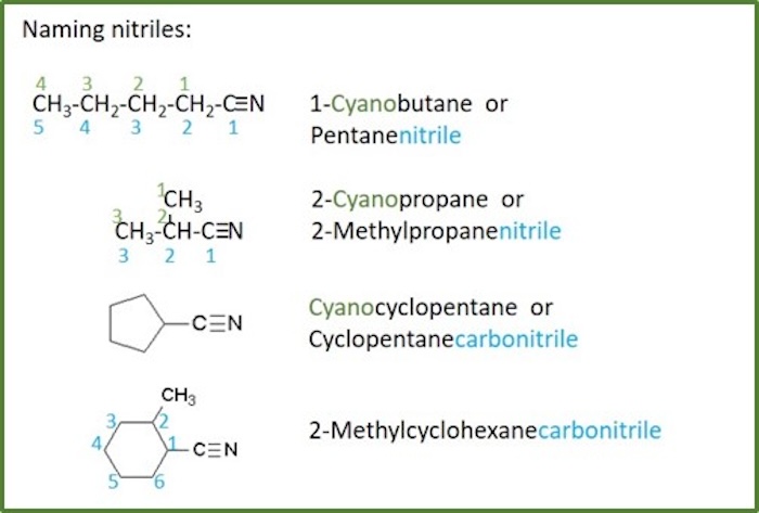

Nitriles
Nitrile: Organic compound that contains an alkyl combined with a - C≡N functional group. Nitriles are also called cyanides , but this is more common in inorganic chemistry.
The nitrile group can also be substitutet to other types of hydrocarbons. If it is connected to e.g. an alkene, it will be a nitroalkene
There are two different ways of naming these compounds:
1. As cyanoalkanes :
  1. The root name is based on the longest chain containing the cyano group.
  2. This root give the alkane part of the name.
  3. The chain is numbered so as to give the cyano group the lowest possible number.
  4. The cyano- prefix is used in a very similar manner to haloalkane s
  5. The cyano group takes precedence after acyl halides and amides, but over aldehydes and ketones, in the naming and numbering of the root chain. For comparison with other groups, see table for functional groups priority.
  6. The cyano nomenclature is most common when the alkyl group is simple.
2. As nitriles :
  1. The root name is based on the longest chain including the carbon of the nitrile group.
  2. This root give the alkyl part of the name.
  3. A - nitrile suffix is placed directly after the alkane part.
  4. Since the nitrile must be at the end of the chain, it must be C1 and no locant needs to be specified.
  5. Cycloalkanes are followed by the word -carbonitrile .
naming nitrilies

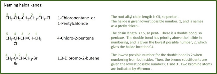

Haloalkanes / alkylhalides
Haloalkane: Organic compound that contains an alkyl combined with a halide group. Haloalkenes contain R-X where X can be F, Cl, Br or I. Haloalkanes are also called alkylhalides.
The halide can also be substitutet to other types of hydrocarbons. If it is connected to e.g. an alkene, it will be a haloalkene
1. As haloalkanes (the IUPAC way):
  1. The root name is based on the longest chain containing the halogen.
  3. The type of halogen defines the halo prefix, e.g. bromo-
  4. The chain is numbered so as to give the halogen the lowest possible number.
  5. When there is a doble bond present together with the halide the double bond is given the preference (priority) in the numbering.
  6. When there are more than one halide atom substituted to the alkyl, the number of halide atoms is indicated with prefixes di-, tri- etc. to the - halo name.
2. As alkyl halides :
  3. The type of halogen defines the halide suffix, e.g . chloride
  4. The chain is numbered to give the halogen the lowest possible number.
  5. The alkyl halide nomenclature is most common when the alkyl group is simple.
naming haloalkanes

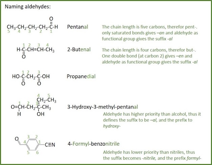

Aldehydes
Aldehyd: An organic compound containing a functional group with the structure −C(=O)H, consisting of a carbonyl center (a carbon double-bonded to oxygen) with the carbon atom also bonded to hydrogen and to an R group (R= any generic alkyl or side chain). The -CHO group is the aldehyde group, also known as the formyl group. An aldehyde can also be named as alkanal.
Naming rules for aldehydes:
  1. The root name is based on the longest chain including the carbonyl group.
  2. It is not necessary to indicate the position of the -CHO group because this group will be at the end of the parent chain and its carbon is automatically assigned as C-1.
  3. The name is formed by changing the suffix -ane of the parent alkane to -anal.
  4. In other cases, such as when a -CHO group is attached to a ring, the suffix -carbaldehyde may be used.
  5. The term formyl- is used as prefix.
  6. When both double bonds and carbonyl groups are present, the -en ( not -ene) suffix follows the parent chain directly and the -al suffix follows the -en suffix.
    1. The location of the double bond is indicated before the root name as before, and the -al suffix follows the -en suffix directly.
  7. If there are more than one -CHO group, the suffix is expanded to include a prefix that indicates the number of -CHO groups present ( -edial )-
    1. There should not be more than 2 of these groups on the parent chain as they must occur at the ends.
  8. The formyl group takes precedence after nitriles and amides, but over ketones and alcohols, in the naming and numbering of the root chain. For comparison with other groups, see table for functional groups priority.
  9. If replacing the aldehyde group with a carboxyl group (−COOH) would yield a carboxylic acid with a trivial name, the aldehyde may be named by replacing the suffix -ic acid or -oic acid in this trivial name by -aldehyde .
naming aldehydes

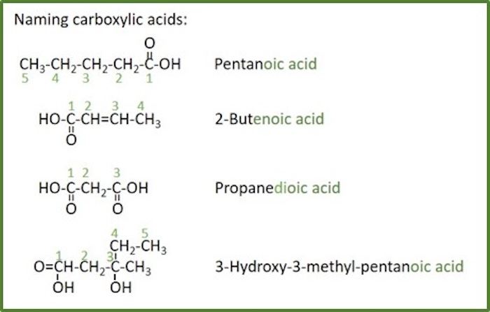

Carboxylic acids
Carboxylic acid: an organic compound that contains a carboxyl group (-C(=O)OH). The general formula of a carboxylic acid is R–COOH, with R referring to the rest of the molecule. There should not be more than 2 of carboxyl groups on the root chain as they must occur at the ends.
Alkanoic acid: A carboxylic acid where the R is an alkyl.
Branched alkanoic acid: A carboxylic acid where the R is a branched alkyl.
Dioic acid: A carboxylic acid with two acid groups, -COOH.
Benzoic acid: A carboxylic acid where the acid group is substituted to one carbon of a benzene ring.
Hydroxy acid: An carboxylic acid containing an additional hydroxyl group.
Naming rules for carboxylic acids:
  1. Carboxylic acids are named by counting the number of carbons in the longest continuous chain including the carboxyl group and by replacing the suffix -ane of the corresponding alkane with -anoic acid .
  2. If there are two -COOH groups, the suffix is expanded to include a prefix that indicates the number of -COOH groups present ( - anedioic acid ).
  3. It is not necessary to indicate the position of the -COOH group because this group will be at the end of the root chain and its carbon is automatically assigned as number 1.
  4. The carboxyl group takes precedence over all other groups in the numbering of the root chain. For comparison of priority with other groups, see table for functional groups priority.
  5. If the carboxyl group is attached to a ring the parent ring is named and the suffix -carboxylic acid is added.
  6. When both double bonds and carboxyl groups are present, the -en suffix follows the root chain directly and the -oic acid suffix follows the -en suffix (the e is left off, -en instead of -ene ).
  7. The location of the double bonds are indicated before the root name as before, and the -oic acid suffix follows the -en suffix directly.
  8. If there is a choice in numbering not previously covered, the root chain is numbered to give the substituents the lowest number at the first point of difference .
naming carboxylic acids

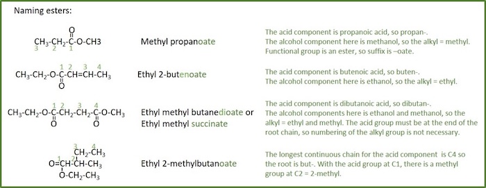

Esters
Ester: An e ster is a compound containing an oxycarbonyl group , with the generalformula R-C(=O)O-R'. It can be derived from the carboxylic acid RCO2H and the alcohol R'OH.
The easiest way to deal with naming esters is to recognise the carboxylic acid and the alcohol that they can be prepared from:
  1. The first component of an ester name, the alkyl is derived from the alcohol, R'-OH portion of the structure.
  2. The second component of an ester name, the -oate is derived from the carboxylic acid, R-CO2H portion of the structure.
  3. Alcohol component
    1. The root name is based on the longest chain containing the -OH group.
    2. The chain is numbered so as to give the -OH the lowest possible number.
  4. Carboxylic acid component
    2. Since the carboxylic acid group is at the end of the chain, it must be C1.
    3. The ester suffix for the acid component is appended after the hydrocarbon suffix minus the "e" : e.g.  -ane + -oate = -anoate.
  5. The complete ester name is the alkyl alkanoate
  6. The oxycarbonyl group takes precedence after carboxylic acids, but over acyl halides and amides, in the naming and numbering of the root chain. For comparison with other groups, see table for functional groups priority.
naming esters

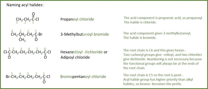

Acyl halides
Acyl halide : An organic compound derived from a carboxylic acid by replacing a hydroxyl group with a halide (-Cl, -Br, -I, -F) group. The compound contains a –C(=O)-X functional group, which consists of a carbonyl group singly bonded to a halogen atom. The general formula for such an acyl halide can be written R-COX, where R may be an alkyl group, CO is the carbonyl group, and X represents the halide. Acyl halides is also called acid halide s.
The nomenclature of acid halides starts with the name of the corresponding carboxylic acid:
  1. The root name is based on the longest chain including the carbonyl group of the acyl group.
  2. The substituent suffix is - oyl halide
    1. The –ic acid ending is removed and replaced with the ending - yl followed by the name of the halogen with an –ide ending. This is true for both common and IUPAC nomenclature.
  3. The carbonyl carbon is given the location number 1. It is not necessary to include the location number in the name because it is assumed that the functional group will be on the end of the root chain.
  4. As substituents they have the priority before amides and nitriles, but after esters. For comparison of priority with other groups, see table for functional groups priority.
  5. Acyl halide as substituent has the prefix halo carbonyl- (where halo can be chloro, bromo, iodo or fluoro)
  6. If more than one functional group, this is indicated by using a numbering prefix (-edi-) directly before the -oyl prefix and before the halide.
naming acyl halides

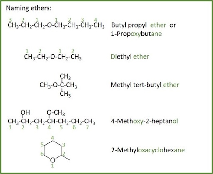

Ethers
Ether: An organic compound that have the general group R-O-R'. R and R' can be smilar or different alkyl substituents.
Naming rules for ethers:
  1. If both groups are simple alkyl groups, then the ether is usually named as alkyl alkyl ether.
    1. The two alkyl groups attached to the oxygen are put in alphabetical order with spaces between the names.
    2. If the two alkyl groups are the same, then it's a dialkyl ether.
    3. This style of naming is not used when one or more of the alkyl groups is complex or has other functional groups.
  2. In IUPAC, ethers are named as alkoxy- substituents with the smaller side being the substituent and the larger side being the main chain.
  3. As substituents they have the same priority as haloalkanes and they do not get a suffix. For comparison of priority with other groups, see table for functional groups priority.
  4. Ether oxygens are NOT generally part of the main chain in linear ethers.
  5. Cyclic ethers are named as oxacycloalkanes with the oxygen being at position 1 of the chain.
naming ethers

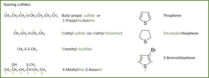

Sulfides (thioethers)
Sulfide: A sulfide is an organosulfur compound of the form R–S–R’ (where R and R’ represents an alkyl or other organic substituent).
Sulfides can be seen as a sulfur analogue to ethers (sulfur takes the place of oxygen in the alkoxy group of an ether). Sulfides are also called thioethers.
Sulfides can contain more than one S atom between the alkyl groups. They are then called disulfides (R-S-S-R') and trisulfides (R-S-S-S-R') etc.
Sulfides are named in much the same way as their oxygen cousins, and the rules for naming of sulfides (thioethers) are quite similar:
  1. If both groups are simple alkyl groups, then the sulfide is usually named as alkyl alkyl sulfide.
    1. The alkyl groups are listed in alphabetical order.
    2. If the two alkyl groups are the same, then it's a dialkyl sulfide (or alkyl thioether ) .
  2. If one of the groups is more complex, then the sulfide group is usually treated as an alkylthio- ( i.e. R-S-) substituent.
  3. The more complex group ( i.e . longer chain, more branched, other substituents) defines the root.
  4. If both groups are complex then the sulfide (thioether) can be named using -thio
  5. As substituents they have priority above haloalkanes and nitrocompounds and they get the suffix sulfide . For comparison of priority with other groups, see table for functional groups priority.
  6. Sulfide sulfurs are NOT generally part of the main chain in linear sulfides.
  7. 5-membered rings with a S in the ring, are named with base in the aromatic thiophene .
    1. If the thiophene is fully or partially saurated, this is indicated by adding a prefix telling how many hydrogen is added to the thiophene.
    2. Numbering cyclic sulfides starts at the S atom, then going towards the higest priority substituent.
  8. Disulfides, trisulfides, etc, and polysulfides are named analogously to sulfides, except that di- , tri- , or poly-sulfide replaces sulfide , and that di- , tri- , or poly-thio- replaces thio- .
naming sulfides
