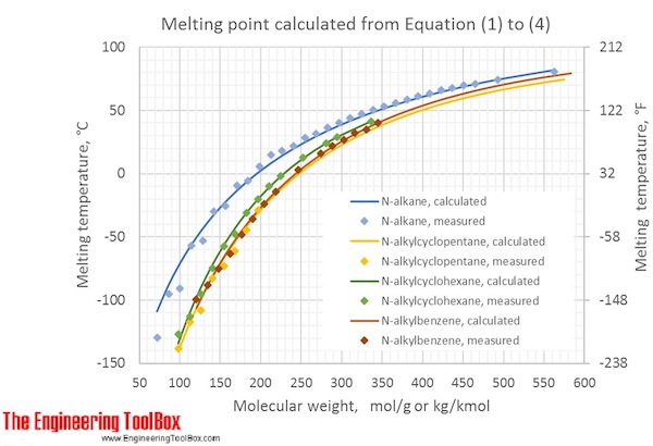

The figure shows calculated melting points (°C and °F) for the different kinds of hydrocarbons at varying molecular weights, compared to measured values:
Melting_point_calculated
