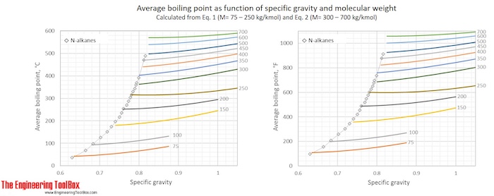

Eq. (1) and (2) are used to calculate T b for a number of specific gravities and molecular weights and the results, in °C and °F, are given in the figures below.
ABP_gravity_MW
