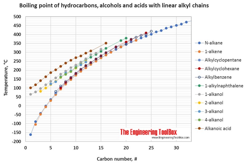

Boiling temperatures (°C and °F) with varying carbon numbers up to C33.
The tables and figures below show how the boiling point changes with increasing carbon number up to C 33 for different kinds of hydrocarbons, alcohols and carboxylic acids. More detailed definitions and examples of molecular structures of the different groups are given below the figures.
  • Melting point - the temperature at which a solid turns into a liquid
  • Boiling point - the temperature at which a liquid turns into a gas
For hydrocarbons with the same carbon number the boiling point increases in the following order:
multisubstituted alkane < singelsubstituted alkane < singelsubstituted alkene < normal alkene < normal alkane < alkyl cyclohexane <  alkylbenzene < cycloalkene < cycloalkane < 2-, 4- and 3-alkanol / 1-alkylnaphthalene  < 1-alkanol < normal alkanoic acid

boiling point figure

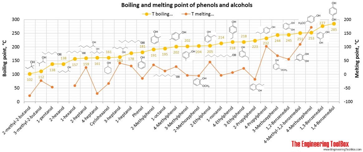

BP and MP of pehenols and alcohols
See also pKa values for phenols, alcohols and carboxylic acids .

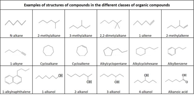

Molecular structure hydrocarbone alcohol acid
Definitions of organic compounds
Main groups of hydrocarbons:
Alkane: An acyclic saturated hydrocarbon, with the general formula C n H 2n+2 . Also called paraffin .
Alkene: An unsaturated hydrocarbon that contains at least one carbon–carbon double bond, with the general formula C n H 2n . Also called olefine .
Alkyne : An unsaturated hydrocarbon containing at least one carbon—carbon triple bond, with the general formula C n H 2n-2 . Also called acetylene .
Cycloalkane: A one-ring (monocyclic) saturated hydrocarbon, with the general formula C n H 2n . Also called naphthene .
Cycloalkene: An alkene hydrocarbon which contains a closed ring of carbon atoms, but has no aromatic character, with the general formula C n H 2n-2 . Also called cycloolefin .
Aromatic hydrocarbon : A cyclic (ring-shaped), planar (flat) molecule with a ring of resonance bonds that exhibits more stability than other geometric or connective arrangements with the same set of atoms. The simplest of the aromatics have 6 carbon atoms and contains 3 double bounds.  A one ring aromatic without any substituents is called benzene, with the formula C6 H6.
Polycyclic aromatic hydrocarbons : hydrocarbon that are composed of multiple aromatic rings. A two ring aromatic without any substituents is called naphthalene, with the formula C 10 H 8 .
Some under-groups of hydrocarbons given in this document:
Alkyl: An alkane substituent missing one hydrogen, with general formula C n H 2n+1
2-Methylalkane: A branched alkane, with a methyl group connected to the second carbon atom in the main carbon chain.
3-Methylalkane: A branched alkane, with a methyl group connected to the third carbon atom in the main carbon chain.
2-Methylalkene: A branched alkene, with a methyl group connected to the second carbon atom in the main carbon chain.
Alkylcycklohexane: A monosubstituted cyclohexane with one branching via the attachment of one alkyl group on one carbon of the cyclohexane ring, with the general formula C n H (2n+1) C6 H 11 .
Alkylcycklopentane : A monosubstituted cyclopentane with one branching via the attachment of one alkyl group on one carbon of the cyclohexane ring, with the general formula C n H 2n+1 C5 H 9 .
Alkylbenzene: A monosubstituted benzene with one branching via the attachment of one alkyl group on one carbon of the benzene ring, with the general formula C n H (2n+1) C6 H5.
Alkylnaphthalene: A monosubstituted naphthalene with one branching via the attachment of one alkyl group on one carbon of one of the aromatic rings, with the general formula C n H (2n+1) C 10 H 7 .
Some other groups of organic compounds:
Alcohol: an organic compound in which the hydroxyl functional group (–OH) is bound to a saturated carbon atom
Alkanol: An alcohol where the hydroxyl group is connected to an alkane
Carboxylic acid: an organic compound that contains a carboxyl group (C(=O)OH). The general formula of a carboxylic acid is R–COOH, with R referring to the rest of the molecule.
Alkanoic acid: A carboxylic acid where the R is an alkane.
