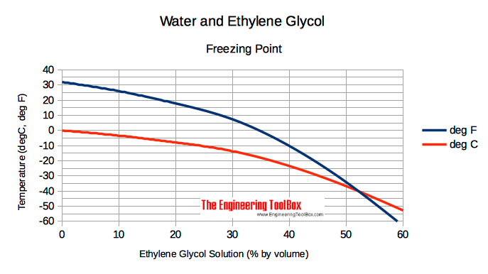

Freezing Point of Ethylene Glycol based Water Solutions
Freezing points of ethylene glycol based water solutions at various temperatures are indicated below
Ethylene Glycol Water Solution Heat-Transfer Fluid - Freezing Point
Ethylene Glycol Solution
( % by volume )
01020304050608090100
Freezing Point ( oF) 32 25.9 17.8 7.3 -10.3 -34.2 -63 ≈ -51 ≈ -22 9
(oC) 0 -3.4 -7.9 -13.7 -23.5 -36.8 -52.8 ≈ -46 ≈ -30 -12.8
Due to possible slush creation, ethylene glycol and water solutions should not be used in conditions close to freezing points.
Water with ethylene glycol - freezing points
