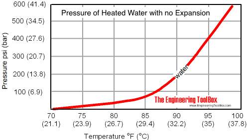

Water - temperature rise and pressure rise in a closed system

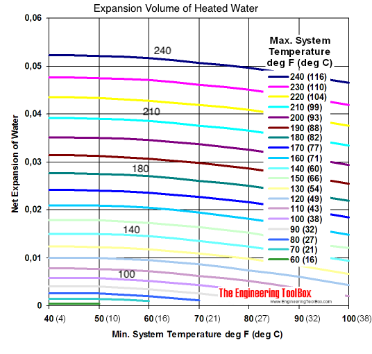

Net expansion volume of water when heated can be expressed as
V net = (v1 / v0 ) - 1                                      (1)
V net = expansion volume of water ( ft3, m3 )
v0 = specific volume of water at initial (cold) temperature (ft3 /lb, m3 /kg)
v1 = specific volume of water at operating (hot) temperature (ft3 /lb, m3 /kg)

Water - temperature volume expansion diagram

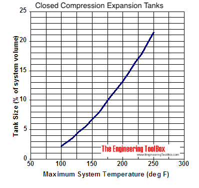

Closed Compression Expansion Tanks
Closed compression tanks can be designed as
  • adjustable expansion tanks - air is evacuated or injected by automatic valves to the tanks to control system pressures when temperature and expansion of water rises or falls
  • pump-pressured cushion tanks - water is evacuated or injected to the systems to compensate for temperature rise or fall
  • compression tanks with closed gas volumes - the tanks contains specific volumes of gas which is compressed when temperatures and system volumes increase
Water - Closed expansion tanks
Required volume in a closed expansion tank
V et = k V w [( v1 / v0 ) - 1] / [( p a / p0 ) - ( p a / p1 )]                                          (3)
p a = atmospheric pressure - 14.7 (psia)
p0 = system initial pressure - cold pressure (psia)
p1 = system operating pressure - hot pressure (psia)
Water - closed expansion tank sizing diagram

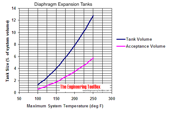

Diaphragm Expansion Tanks
Required volume in a diaphragm expansion tank
V et = k V w [( v1 / v0 ) - 1] / [1 - ( p0 / p1 )]                                            (4)
Water - diaphragm exspansion tank sizing diagram
  • initial temperature 50 oF
  • initial pressure 10 psig
  • maximum operating pressure 30 psig
  • safety factor aprox. 2
  • acceptance factor aprox. 0.5
