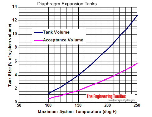

Temperature in degrees Fahrenheit and pressure in psig
  • initial temperature 50oF
  • initial pressure 10 psig
  • maximum operating pressure 30 psig
  • safety factor aprox. 2
  • acceptance factor aprox. 0.5
The diagram below can be used to estimate the tank volume and acceptance volume of a diaphragm expansion tank at low temperatures.
Diaphragm expansion tanks -  sizing diagram in fahrenheit

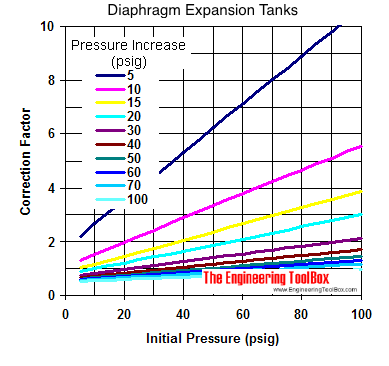

For initial and maximum pressures different from above - multiply the tank size with the a correction factor estimated from the diagram below:
Diaphragm expansion tanks -  sizing diagram in psig

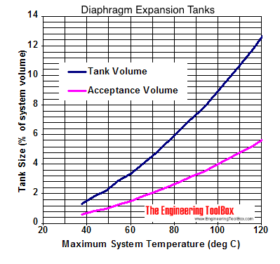

Temperature in degrees Celsius- pressure in kPa
  • initial temperature 10oC
  • initial pressure 70 kPa
  • maximum operating pressure 200 kPa
The diagram below can be used to estimate the tank volume and acceptance volume of a closed expansion tank at low temperatures.
Diaphragm expansion tanks -  sizing diagram in celsius

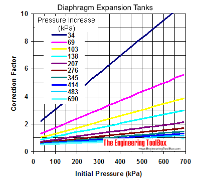

Diaphragm expansion tanks - sizing diagram in kPa
