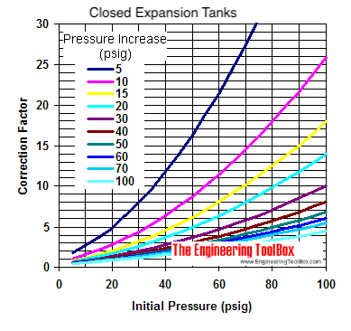

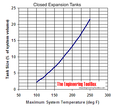

Temperatures in degrees Fahrenheit and pressure in psig
  • initial temperature 50oF
  • initial pressure 10 psig
  • maximum operating pressure 30 psig
  • safety factor aprox. 2
The diagram below can be used to estimate the size of a closed expansion tank at low temperature.
Closed expansion tanks - sizing diagram in fahrenheit
For initial and maximum pressures different from above - multiply the tank size with the a correction factor estimated from the diagram below:
Closed expansion tanks - sizing diagram in psig

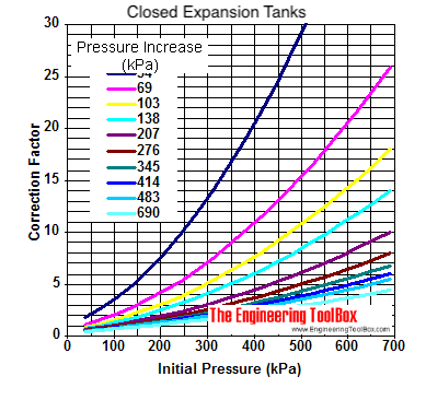

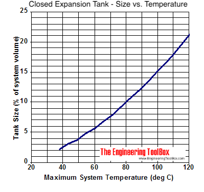

Temperatures in degrees Celsius and pressure in kPa
  • initial temperature 10oC
  • initial pressure 70 kPa
  • maximum operating pressure 200 kPa
The diagram below can be used to estimate the size of a closed expansion tank at low temperatures.
Closed expansion tanks -  sizing diagram in celsius
Closed expansion tanks -  sizing diagram in kPa
