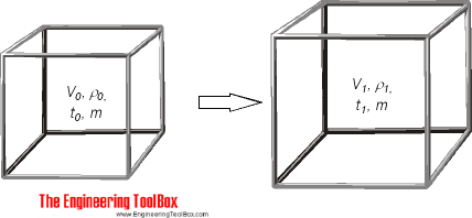

Specific volume of a unit can be expressed as
v = 1 / ρ = V / m                                                          (1)
v = specific volume (m3 /kg, ft3 /lb)
ρ = density (kg/m3, lb/ft3 )
V = volume of unit (m3, ft3 )
m = mass of unit (kg, lb)
The change in the units volume when temperature changes can be expressed as
dV = V0 β (t1 - t0 )                                                        (2)
dV = V1 - V0 = change in volume (m3, ft3 )
β = volumetric temperature expansion coefficient (m3 /m 3 o C, ft3 /ft 3 o F)
t1 = final temperature ( oC, oF)
t0 = initial temperature ( oC, oF)
The density of a fluid when temperature changes can be expressed as
ρ1 = m / V0 (1 + β (t1 - t0 ))
= ρ0 / (1 + β (t1 - t0 ))                                                (3)
ρ1 = final density (kg/m3, lb/ft3 )
ρ0 = initial density (kg/m3, lb/ft3 )

100 liters - 0.1 m3 - of oil with volumetric expansion coefficient 0.00070 1/ oC is heated from 20 oC to 40 oC . The volumetric expansion can be calculated using equation (2)
dV = (0.1 m3 ) (0.00070 1/ oC) ((40 oC) - (20 oC))
= 0.0014 m3
= 1.4 liter
The final volume is
100 liters + 1.4 liters = 101.4 liters
Example - Cubic Expansion of Oil
30 US gallons of oil is heated from 7 0 oF to 100 oF . The volumetric expansion can be calculated using equation (2)
dV = (30 gallons) (0.00039 1/ oF) ((100 oF) - (70 oF))
= 0.351 gallons
The final volume is
30 gallons + 0.351 gallon = 30.351 gallons
