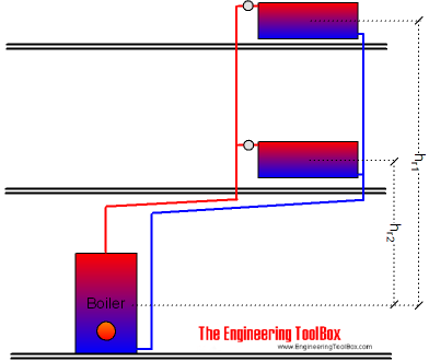

The density difference between hot and cold water is the circulating force in a self circulating gravity heating system.
A self circulation heating system operates by the force created by the density difference between hot and cold fluid.
Gravity heating system
Gravity Head
The head forcing circulation through a gravity system is proportional to the elevation - he - of the heating elements (or radiators) above the boiler, and the temperature difference between the flow and return pipe lines.
The head available for circulation can be calculated
hl = hrr - ρf) / [(ρr + ρf) / 2]                                            (1)
hl = head available for circulation (m, ft)
hr = height of radiator or heating element above boiler (m, ft)
ρf = density of water in flow (hot) pipe (lb/ft3, kg/m3)
ρrdensity of water in return (cold) pipe (lb/ft3, kg/m3)

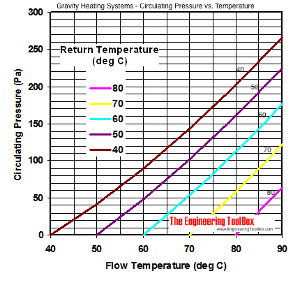

Circulating Pressure - Flow and Return Temperature
The forcing pressures in self circulation system with operating temperatures between 50 to 95oC are indicated in the diagram and table below.
Gravity heating system - pressure difference diagram
Gravity Heating System - Circulating Pressure vs. Temperature Difference
Return Temperature
(oC)
Circulating Pressure in Pa (N/m2) per m circulating elevation - he
Flow Temperature (oC)
405060708090
90           0
80         0 64
70       0 59 123
60     0 54 113 177
50   0 48 101 161 225
40 0 41 89 143 203 267
