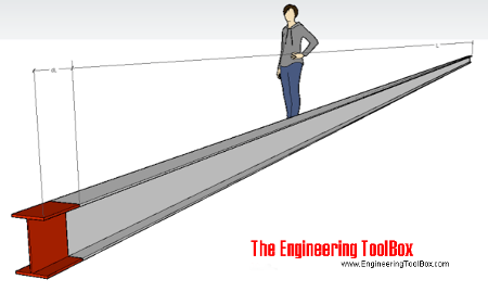

Example - Expansion of an Aluminum Beam
Aluminum beam - thermal expansion
An aluminum construction is designed for temperatures ranging -30 oC to 50 oC . If a beam's length is 6 m when assembled at 20 oC - the shortest final length of the beam at minimum temperature -30 oC can be calculated as
L1 = (6 m) + (6 m) (0.000023 m/m oC) ((-30 oC) - (20 oC))
= 5.993 m
The longest final length of the beam at maximum temperature 50 oC can be calculated as
L1 = (6 m) + (6 m) (0.000023 m/m oC) ((50 oC) - (20 oC))
= 6.004 m
