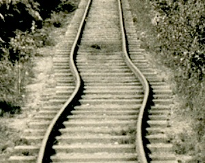

When an object is heated or cooled, its length change by an amount proportional to the original length and the change in temperature.
railway thermal expansion
