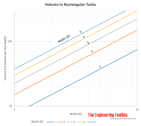

Rectangular Tanks - Volumes
Tank volume per foot depth.
Tank Dimension
(ft x ft)
Volume
(U.S. gallons per foot of depth)
2 x 2 29.9
2 x 3 44.9
2 x 4 59.9
2 x 5 74.8
3 x 3 67.3
3 x 4 89.8
3 x 5 112
4 x 4 120
4 x 5 150
5 x 5 187
  • 1 ft = 0.3048 m
  • 1 Gallon (U.S.) = 3.785 liter = 3.785x10-3 m3
Volume in rectangular tanks
