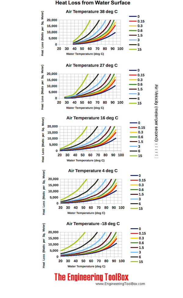

Heat Loss from Water Surfaces Chart - Metric Units
Heat loss from open tanks or swimmingpools chart
Heat loss are for open tanks in 60 oF still ambient air.

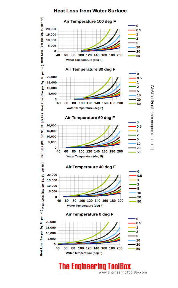

Heat Loss from Water Surfaces Chart - Imperial Units
  • T(oC) = 5/9[T( oF) - 32]
  • 1 Btu/(ft2hr) = 3.1525 W/m2
