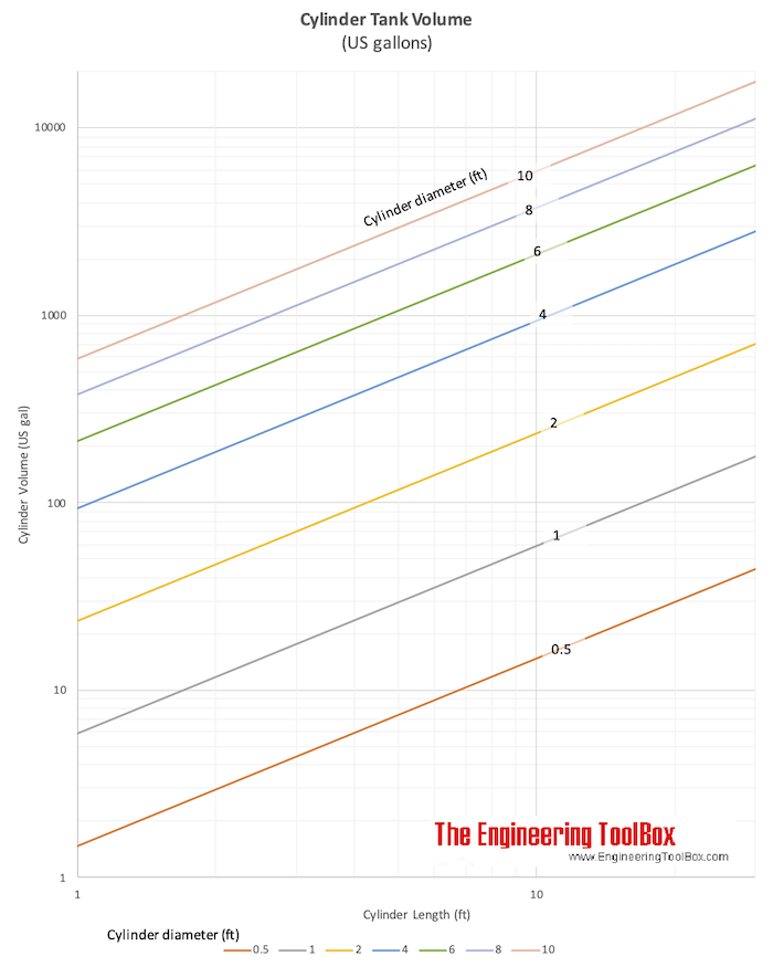

Cylinder Tank Volume Chart (us gallons)
Download and print Cylinder Tank Volume Chart (us gallons)

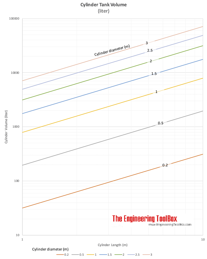

Cylinder Tank Volume Chart (liter)
Download and print Cylinder Tank Volume Chart (liters)
