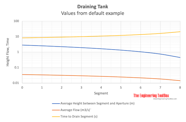

Draining Tank Calculator
This calculator is based on eq. (1b) and can be used to estimate the volume flow and time used to drain a container or tank through an aperture.
The calculator divides the container in "slices" and makes an iterative average calculation for each slice. The accuracy of the calculation can be increased by increasing the number of slices.
- results in table below!
Note! - the flow is reduced and the time is increased with reduced height.
Draining tank - flow, time and level - values from default example
