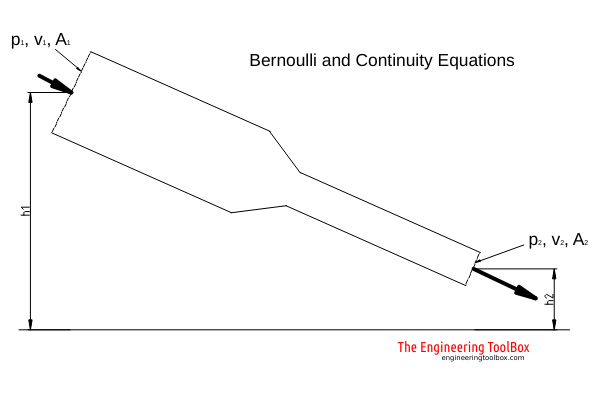

A special form of the Euler’s equation derived along a fluid flow streamline is often called the Bernoulli Equation:
Bernoulli equation
Energy Form
For steady state in-compressible flow the Euler equation becomes
E = p1 / ρ + v12 / 2 + g h1
= p2 / ρ + v2 2 / 2 + g h2 - Eloss
= constant                                             (1)
E = energy per unit mass in flow (J/kg, Btu/slug)
p = pressure in the fluid (Pa, psf)
ρ = density of fluid (kg/m3, slug/ft3)
v = velocity of fluid (m/s, ft/s)
Eloss = energy loss per unit mass in flow (J/kg, Btu/slug)
1 psi = 144 psf
Head Form
(1) can be modified by dividing with gravity like
h = p1 / γ + v12 / (2 g) + h1 = p2 / γ + v2 2 / (2 g) + h2 - Eloss / g
   = constant                                                                                      (2)
h = head (m fluid column, ft fluid column)
γ = ρ g = specific weight of fluid (N/m3, lbf/ft3)
Equation (2) is often referred to as the "head" because all elements has the unit of length.
Note! - the head unit is with reference to the density of the flowing fluid. For other units - like mm Water Column - check Velocity Pressure Head.

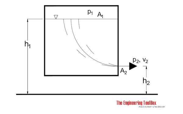

Discharge from a Pressure Vessel - Bernoulli Equation and Flow from a Tank through a small Orifice
Liquid flows from a tank through a orifice close to the bottom. The Bernoulli equation can be adapted to a streamline from the surface (1) to the orifice (2) :
Bernoulli equation - flow out of tank example
= p2 / γ + v2 2 / (2 g) + h2 - Eloss / g                           (4)
By multiplying with g and assuming that the energy loss is neglect-able - (4) can be transformed to
= p2 / ρ + v2 2 / 2  + g h2                                 (4b)
Discharge Velocity
If
h = h1 - h2                                           (4c)
and (according the continuity equation)
v1 = (A2 / A1) v2                                       (4d)
then the velocity out of the orifice can be expressed as
v2 = ((2 / (1 - A2 2 / A12)) (g h + (p1 - p2) / ρ))1/2                        (5)
Vented Tank
For a vented tank where the inside pressure equals the outside pressure
p1 = p2                              (5b)
and the surface area is much larger than the orifice area
A1 >> A2                          (5c)
- then eq. 5 can be modified to
v2 = (2 g h)1/2                         (6)
"The velocity out from the tank is equal to speed of a freely body falling the distance h ." - also known as Torricelli's Theorem.
Example - outlet velocity from a vented tank
The outlet velocity from a tank with level 10 m can be calculated as
v2= (2 (9.81 m/s2) (10 m))1/2
= 14 m/s
