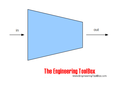

For a simple reduction (or expansion) as indicated in the figure above - the equation of continuity for uniform density can be transformed to
vin Ain = vout Aout                             (3)
or
vout = vin Ain / Aout                            (3b)
