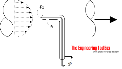

The Pitot Tube
The pitot tube is a simple and convenient instrument to measure the difference between static, total and dynamic pressure (or head).
Flow meter - pitot tube
The head - Δh - (or pressure difference - Δp) can be measured and calculated with the help of u-tube manometers, electronic pressure transmitters or similar instrumentation.

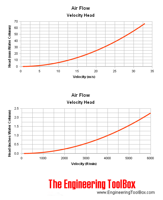

Air Flow - Velocity and Dynamic Head Chart
The charts below are based on air density 1.205 kg/m3 and water density 1000 kg/m3
Air Flow - Velocity and Head
Note that as indicated in the diagram above - pitot tubes are not suited for low velocity flow. Due to low dynamic pressure (head) the readings will be inaccurate.

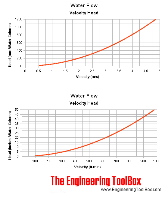

Water Flow - Velocity and Dynamic Head Chart
Water Flow - Velocity and Head

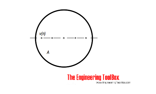

Flow Metering - Point Velocity Area Method
The point velocities in a duct, channel or pipe can be measured by traversing the cross-sectional area of the conduit. The point velocities can be used to calculate the average velocity that can be used to estimate the flow.
Point Velocity Area Method for Flow Volume  Metering
The average velocity can be calculated as
va = Σ vn / n
    = (2 g Σ hn / n )1/2              (6)
va = average velocity (m/s, ft/s)
vn = point velocity (m/s, ft/s)
hn = point height difference pitot meter  (m, ft)
n = number of point velocities
The volume flow in the conduit can be calculated as
q = va A                     (7)
q = flow (m3/s, ft3/s)
A = cross-sectional area (m2, ft2)
For round ducts larger than 10 inches the average velocity can be calculated as the arithmetic middle of a 10 point traverse from inward side wall with distance
  • 2%, 8%, 15%, 23%, 34%, 66%, 77%, 85%, 92% and 98%
For smaller ducts the the average velocity can be estimated to 81% of centerline velocity.
