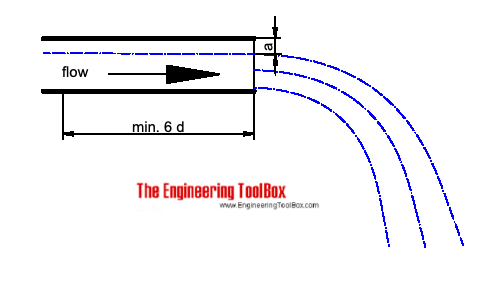

With the California Pipe Flow Metering Method the discharge from the open end of partially filled horizontal pipes discharging freely into the air can be measured.
Califorina Pipe Flow Metering Method
The discharge can be calculated as
q = 8.69 (1 - a / d)1.88 d2.48                           (1)
q = discharge (ft3/s)
a = distance in the plane end of the pipe - from the top of the inside surface of the pipe - to the water surface (ft)
d = internal diameter of pipe (ft)
The equation is empirical and can be used for pipes in the diameter range 3 - 10 in

California Pipe Flow Example
In the discharge on a horizontal 4 inches PVC sewer pipe the distance from the top inside pipe to the water flow is 3 inches (0.25 ft). The inside diameter of the PVC pipe is 4.069 in (0.34 ft)
q = 8.69 (1 - (0.25 ft) / (0.34 ft))1.88 (0.34 ft)2.48
   = 0.049 ft3/s
