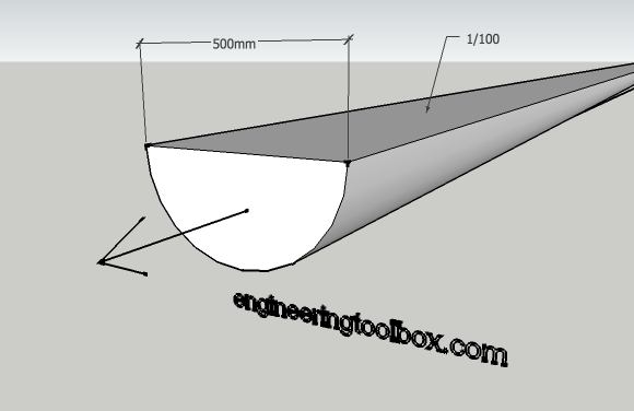

A channel with the shape of an half circle is 100% filled. The diameter of the half circle is 500 mm (0.5 m) and the channel is made of concrete with Manning coefficient 0.012 . The slope of the channel is 1/100 m/m .
mannings formula open channel flow
make 3D models with the free Engineering ToolBox Sketchup Extension !
The cross section area of the half circle flow can be calculated as
A = (0.5 π ((0.5 m) / 2)2)
= 0.098 m2
The wetted perimeter of the half circle flow can be calculated as
P = 0.5 2 π (0.5 m) / 2)
= 0.785 m
The hydraulic radius of the channel can be calculated from (2) as
R h = A / P
= ( 0.098 m2> ) / ( 0.785 m )
= 0.125 m
The cross sectional mean velocity can be calculated from (1) as
v = (k n / n) R h 2/3 S 1/2
= (1.0 / 0.012) (0.125 m) 2/3 (1/100 m/m) 1/2
= 2.1 m/s
The volume flow can be calculated from (3) as
q = A v
=  ( 0.098 m2) (2.1 m/s)
= 0.20 m3 /s
