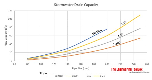

Stormwater Drain Pipe Capacity
download as pdf
Storm-Water Conductors - Capacities - Metric Units
Pipe Size DN
(mm)
Capacity (l/s)
Vertical Roof DrainsHorizontal Sloped Pipe
(slope cm/m)
12.14.2
80 5.8 2.1 3.0 4.3
100 12 4.9 6.9 9.9
125 22 8.8 12 18
150 36 14 20 28
200 76 30 43 60
250 54 77 109
