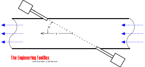

The Time of Flight Ultrasonic Flow meter
With the Time of Flight Ultrasonic Flow meter the time for the sound to travel between a transmitter and a receiver is measured. This method is not dependable on the particles in the fluid.
Ultrasonic flow meter
Two transmitters / receivers (transceivers) are located on each side of the pipe. The transmitters sends pulsating ultrasonic waves in a predefined frequency from one side to the other. The difference in frequency is proportional to the average fluid velocity.
The fluid velocity can be expressed as
v = [(t2 - t1) / (tt1)] (l / 2cosΦ)                                 (2)
v = fluid flow velocity (m/s)
t1 = transmission time downstream (s)
t2 = transmission time upstream (s)
l = distance between sensors (m)
Φ = the relative angle between the transmitted ultrasonic beam and the fluid flow
